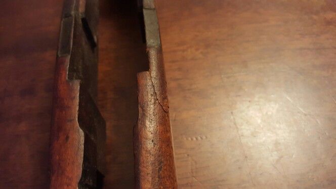

maybe it's not mounted correctly in the stock or is the light coming from an unblocked selector switch hole- and does the crack go all the way through to the bed or is it just a surface crack?- personally , I wouldn't touch it as you just don't bondo or wood glue a rifle stock back together- all my m14s wear usgi firberglas or norinco fiberglas ( and there\s 7 of them)b/c of "swelling"and I believe( and others can chime in ) that a NEW BOYDS stock isn't that much- and you can migrate the metal bits from your norinco stock to your boyds with little problem- just my 2 c- the dummy selector switch can be home made or bought off the internet-last time I looked it was like 12 bucks usd--most of that was shipping- most of us end up filling the hole with fiberglas after screwing a small backing plate to the inside of the stock, then paint it the same colour as the stock
I just checked- the boyds slimline without the selector switch cutout is 104 usd according to their website- even with the low dollar and shipping etc- that STILL less than what your so-called friend wants- and theirs isn't cracked- 2 minutes with a drill or router will give you that selector hole you want or you can make one with a bolt and cap nut- trust me, the selector switch thing isn't ALL THAT
and if you do get a usgi or a boyds, be sure and do the popsicle stick trick so your pin doesn't "walk " out

Right on. The cracks is all the way through. That's what's bothering me the most.

i do know how to repair that crack as well , but why bother with all that work- it's similar to repairing the main spar on an avro anson and involves cutting the crack wider, putting in a piece to match, gluing the thing, and laying a fiberglas mat -

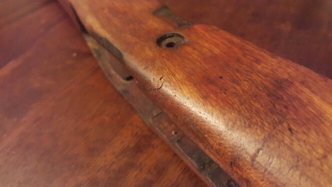

Here is what it ends up looking like with wood.
Sorry for the crappy pictures, my GF has the camera now so I took then with my phone in terrible lighting...
Do you guys think it will be an issue?
