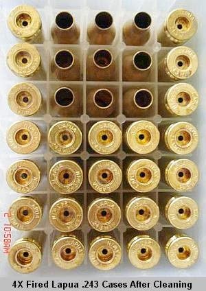

I've got the Hornady 2.0 litre cleaner. Used with hot water, a scant teaspoon of Lemishine, and a squirt of Dawn dish soap it does a good job on brass. Usually one 30 minute cycle using the heat option is enough.
Dump the solution after every load, it doesn't clean as well the second time around. It's dirt cheap anyway.
Rinse with hot fresh water after the clean cycle, then dry in a 180 F oven for 30 mins. Turn oven off and let cool completely to make the most of the heat.
I bought the generic copy of the Lyman ultrasonic cleaner below for $83.99 last year on Amazon. Shop around I have seen it as low as $50.00 US and It works very well. Just remember the hotter the water the better they clean, and it may take a few cycles for the water to reach the proper temp. I fill it with hot tap water so it reaches the proper temp faster and run it for four 8 minute cycles. I use the same dish soap and Lemi-Shine as I do in my wet tumbler. It does not have the same bling as wet tumbling but you do not get any case mouth peening.

I’ve got a Hornady cleaner that Ive had for about 10 years. Lymans brass cleaner solution concentrate, it does a couple hundred rounds at a time. I usually toss it in vibratory cleaner for a few hours first, then run it through the ultrasonic cleaner for about 10 min. to clean any polishing rouge off of it. They come out sparkling clean and ready to load. I also punch the primers first to clean the pockets well. it’s dirt cheap to use, works really well, and does as many as I want done in a given session
