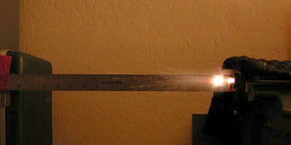

Below a Winchester large rifle primer.

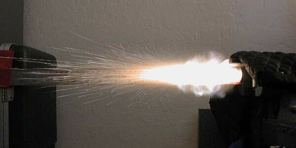

Below a Remington 9 1/2 large rifle primer.

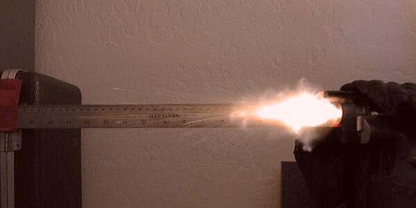

Below a CCI BR4 Small Rifle primer.
Below a Remington 7.5 Small Rifle primer.
Bottom line, when you are standing on your hind legs shooting at a running deer in cold weather I can't tell any difference in primers. But the largest caliber rifle I have is a 30-06 and for years all I used were Remington primers. Remington ran our Lake City Army ammunition plant from 1941 until 1982 and used 7 1/2 and 9 1/2 primers to light off Winchester ball powders. So go figure and pick the primer that works best for you.
