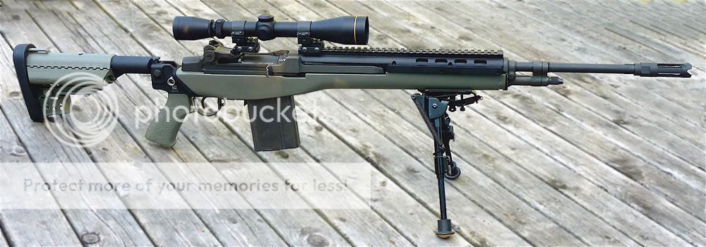

Use a scope mount made for that. I use one made by a the guys at m14 . ca that allow you to still have the utg rail mounted.. for other accessory:
On the plus side, the mount look exactly like the receiver at normal ligth.
