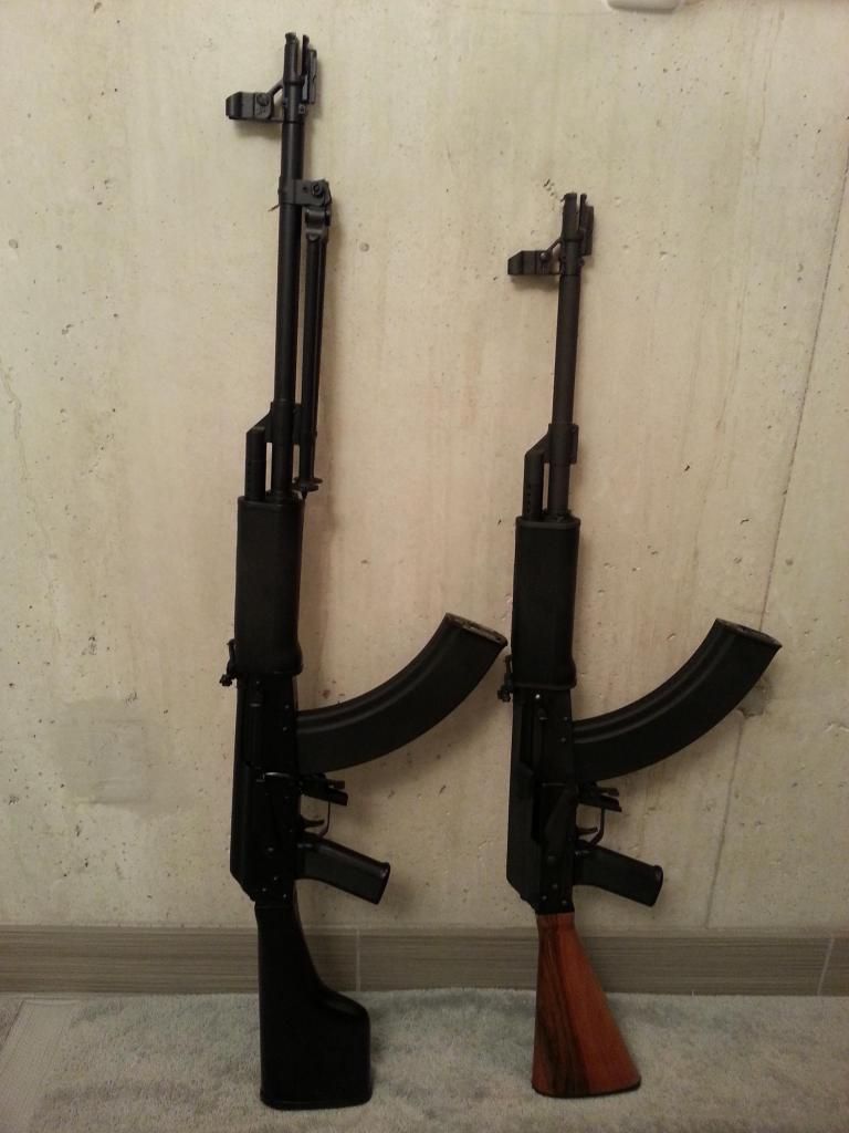

All other AK receivers are prohibited except the ones as listed which are of the Valmet hunter series and are easy to find at the justice site in the firearms regulations section or as fenceline says. You can buy replacement parts for Valmets from Stoeger Canada in Whitby through your local or major gun dealer as I have for a 30-06 Hunter I once had. Stoeger was the original importer of the Valmets and together fought with the hunters up north to keep them from becoming prohibited.---Dieseldog!

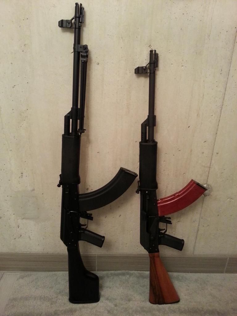

I have a nos yugo sks threaded barrel in the white. I wonder... I'm currently on hunter conversion number 3. Dlask arms helped me out huge. They took a while but as always the end result made it worth the wait. Unfortunately they told me it screws up their production too much doing one offs so they won't do any more valmet work. One is an M76 clone with an original black plastic angle cut stock along with all M76 parts except hunter receiver and hunter barrel cut down to 18.6", the other is a .223 M71 clone which I may use my second (!) Black plastic M76 angle cut stock or I may fab up an angle cut adapter for the wood M71 straight cut stock and last is a .308 Galil which the last thing I'm doing is milling a slot in the underside of the receiver for the left side selector seen on real Galils. Lots of work but when you have the coolest (legal) AK obtainable it's worth it!
