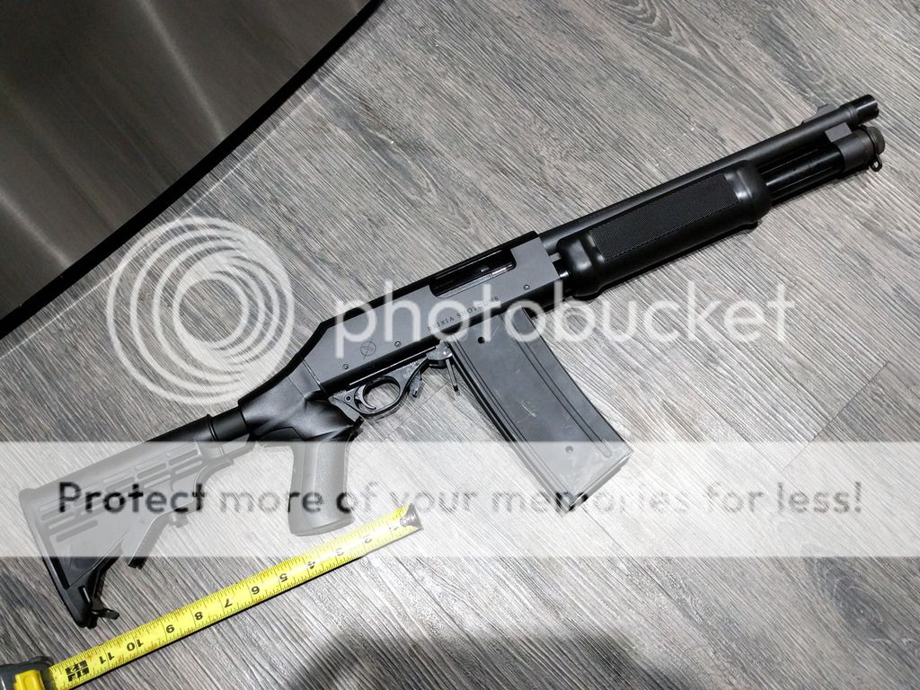

Requires some modifications (Milling)
But me and phat eagle (Phats Idea) used a mossberg 500 mesa stock
adapter

YES the stock LOP sucks......
Did you compare with an 870 adaptor or you just used what you had (500)?
Since it's an italian gun I'd be curious to test Beretta, Benelli, Franchi but don't have any.
I did consider the 870 and had access to both. Cant recall why one was chosen over the other though.
My buddy that did the machining on it I think saw something that made it easier on the 500
I modded a stock as well... But the lines don't line up and it irks me.
But it's waaaay better. No idea why they made the factory stock so long. Silly.

I simply took a hack-saw to my overly long buttstock, reducing it by 2". Then I just put on a slip-over recoil pad and called it a day. The Brixia buttstock is hollow and could use some sort of filler to brace the center of the recoil pad, but that's a project for a different day. I'm thinking a piece of cured/dry wood carved to fit could work nicely...

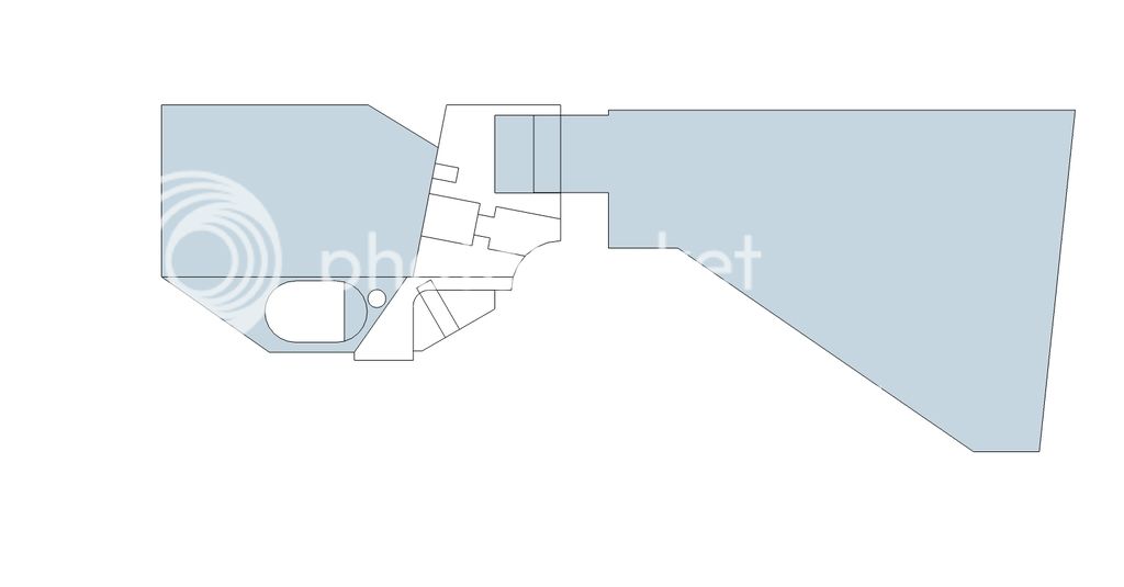

I modified the stock adapter for JoKa PM5 shotgun and modified a SAP6 magazine to work in the shotgun as well. I later on made a stock adapter for my SAP 6 shotgun. Reviewing my drawings one could be made for the PM5 as well.
Here is the on my SAP 6
Here is a drawing of one for the PM5
Very Nice!
Incorporate a space for the sling-plate that comes with the shotgun (or put in a QD socket on both sides if space allows it) and I'd be all over this.
I like how it fills the gap behind the trigger-guard. If it matched the lines of the receiver this would be a hot item for all PM5 owners. I'd buy one in an instant.
My shotgun would get donated to AirCav so he could perfect the fit.
The nice thing with his design is how much higher the buffer tube is vs the moss500 adapter modification.
With my adapter, if you are running optics you need a TALL cheek raiser to see through the optics. With AirCavs design that isnt a problem.

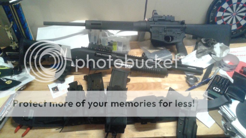

Warren, you were asking about tacos. aircavs rig shows them off with the sap6 mags.
the very far left would be his AR mag
