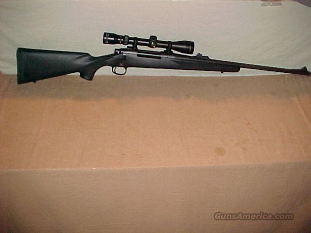

Got photos of the rifle?...........Remington never made their "ADL" model with a synthetic stock, to my knowledge. I assume you are referring to no bottom metal and a blind magazine. I have several bolts for 700s but I'm not interested in selling or trading any, however I would be interested in buying your rifle. PM me please. The other option would be to rebarrel to a standard cartridge and sell the unfired 7 mag barrel, but again it'll end up costing a few hundred dollars.

Not mine, but identical. ADL synthetic was introduced in 1996...Thought about buying a take-off .30-06 but not sure about the feeding through a mag action feed rails.
It's a push feed action...why not just load up the mag with .270 ammo and see if it feeds properly?

Around 2009/2010 Remington sold a bunch of 700 ADLs with both synthetic and birch stocks. I don't think they were ever cataloged items, but were instead sold as distributor exclusives. My guess is they were just burning up old ADL parts. My Dad bought one that had a birch stock with a cheesy fleur-de-lis checkering pattern. I think it was $450 BNIB.
