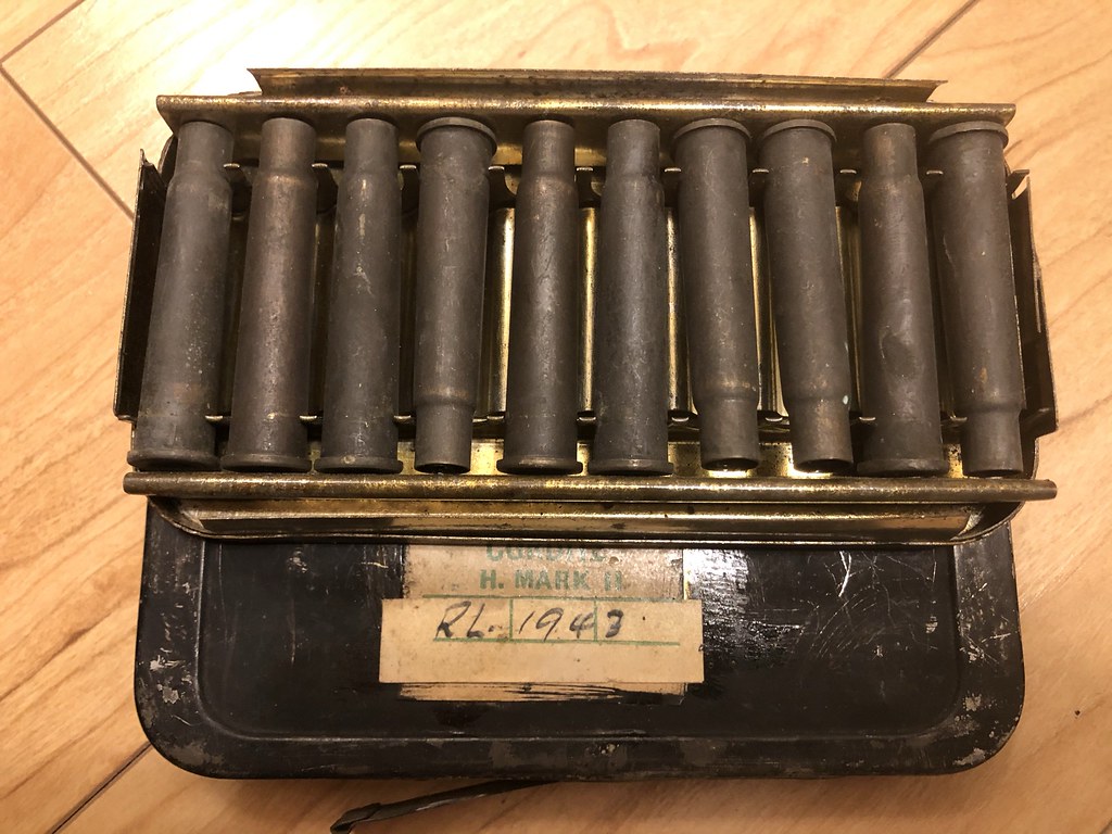

Grenade launching blanks are not the same as noise making ones. Using a noise maker with a grenade launcher is going to result in a burst rifle.
