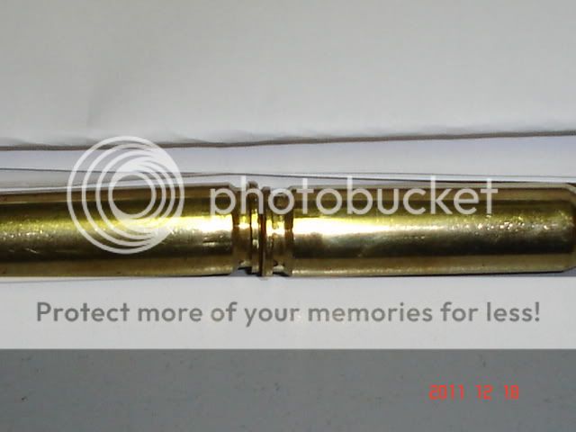

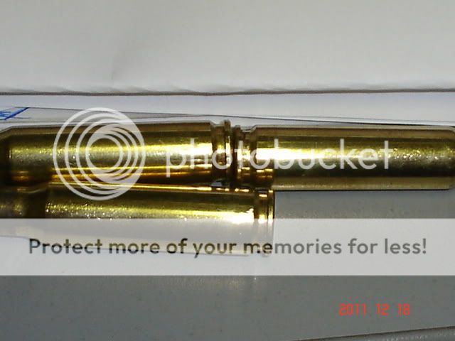

I have two Weatherby Vanguards, both purchased about a year ago. I am experiencing unique casing failures in both.
The first was a Vanguard in 243. The casing showed a protruding ring about a 1/4" from the case head. With your fingernail, you could definitely feel the "bump" of the ring with your fingernail. Two casings split circumferentially at that spot. I headspaced the bolt and it closed on a nogo gauge but not a field gauge. I figured it was a headspace issue.
The second is my vanguard carbine in .308. Up till today, the thing shot beautifully, no issues. I was shooting factory Winchester ammo and bazinga, the ring appeared on those cases, very similar to the 243, except this time, the bolt does not close on the nogo.
What the hell? This same failure occurring about 1.5 years after owning the rifles? I do not believe in coincidence. I do reload, and do not load at or over the maximum published data in the Nosler or Hornady manuals.
Is there an issue with the Vanguards? Has anyone else noticed this issue?

KI have no explanation to your troubles, but would be interested to see a picture of the failures.

The actual case separations would easily be explained by incorrect head space, as closing on the no go gauge indicates. As for the so called ring on the cases out of the second rifle, a picture would be great, as I have heard several similar complaints that turned out to be nothing worth worrying about.

Just to clarify, the 308, is the carbine and that is the one which is now developing the rings.
Winchester SuperX 150 gr always shot pretty decent in this rifle. The bolt on this rifle does NOT close on the nogo. This is the first time I noticed on this rifle. I thought it might have been the ammo, so I introduced another box. Same thing. With the 243, it has started to actually split the casings and that one now closes on the nogo. Since it is now my son's...we are not shooting it until a gunsmith looks at. However, with my 308, I am really stunned. The ammo was straight out of the box.
I may be on the market for a new carbine! Maybe Savage or the Ruger?
Excess headspacing issues usually result in (well, okay, always eventually result in) the case stretching and the appearance of a thin band of brass just above the case head which produces a dimple inside the case and not a bulge on the outside. Your pictures look like your brass is actually expanded for most/all of it's entire length, which could suggest higher pressures and difficult extraction? Hard to tell by the pictures. Perhaps measure the diameter of your cases at several points along their length on factory, fully sized new, and once fired cases and see how much the case diameter grows at various places upon firing them. Having said this, the cases in your picture do appear to have the tell tale beginnings of a case head separation condition. Try the bent paper clip check along the inside wall of the case to see if there is a 'ring' near the case head caused by thinning case material.

I think if you examine the cases with the splits, you will see that they are splitting just above where the visible pressure ring [that is normal] appears on a once fired case.
I am thinking that the split cases are because of oversizing the brass [pushing the shoulder back just a little too far.
The pressure rings I see in your pictures do not seem abnormal.
While a bolt that will close on a no-go, but not a field gauge has a bit of excess headspace, correctly sized brass for this chamber will not split [or separate]
Show us a "split" case. Then we can better identify the problem.

Is the photo of case from carbine a new lot of factory loads?
Do you reload for the carbine as well (unclear in op)?
Have you miked the case head and bulge diameters?
Were these bulges not showing up before in cabine?

The pictures shown are strictly factory on the 308. That rifle mostly sees the Remington cheap stuff, I have a bazillion cases to demonstrate that, but not one of them have that stretch mark. Which got me thinking as to whether the problem is indeed the ammo. In particular, perhaps an undersized case. c-fbmi has a really good point which I am going to explore further. I will head out to range tomorrow or Wednesday and shoot some other ammo brand and a few of my M14 loads and post the results.

Have you measured the diameter of the 'bulge'?
Often brass is manufactured under size and when fired in a correctly sized chamber dimension a bulge will appear as pictured.
Lets have some diameter measurements... A fired case measuring .470" - .471" is perfectly normal and will look quite bulged if it measures .466" - .467" before firing. I have seen Winchester brass as small as .465".
can you slice your cases open and post pictures? I'd be interested in seeing how badly the area in the bulge is thinning.
As well, take a micrometer to the casings, both before and after firing. It could be a combination of small issues.
Douglas and Dennis have it right. This is exactly what is going on here, and is why only some of the brass is showing a bulge. If it was an oversize chamber, all the brass should show the bulge.
