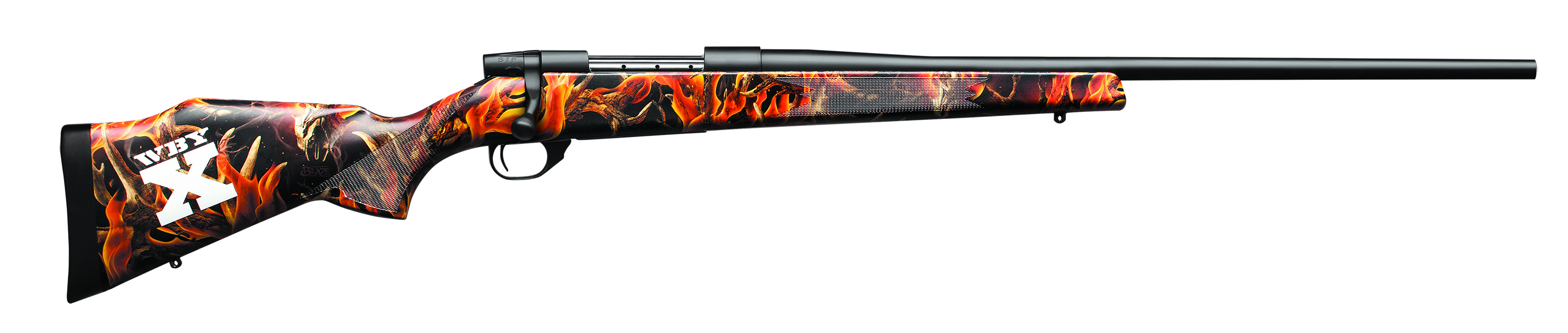

Vanguard (II)
The trigger, safety, and stocks are different.
Trigger is 2 stage in V2 vs single stage in V1.
Safety is 3 position on V2 vs 2 position on V1.
Stock is higher grade polymer on V2.
Just note there are still some V2 rifles in V1 stocks....
This is an s2 stock on top, S1 on bottom, there are lots of different camo patterns but pay attention to the grip area and forestock that distinguish it from the v1
