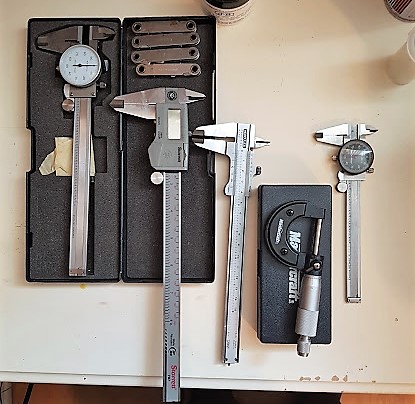

I have a digital, a dial and a vernier.
I don't trust the digital. I prefer the dial. Very easy to read quickly.

I've never had a dead battery on my dial caliper. Digital battery seems to be dead at the most inopportune times, usually when I just used the last battery for something else.
