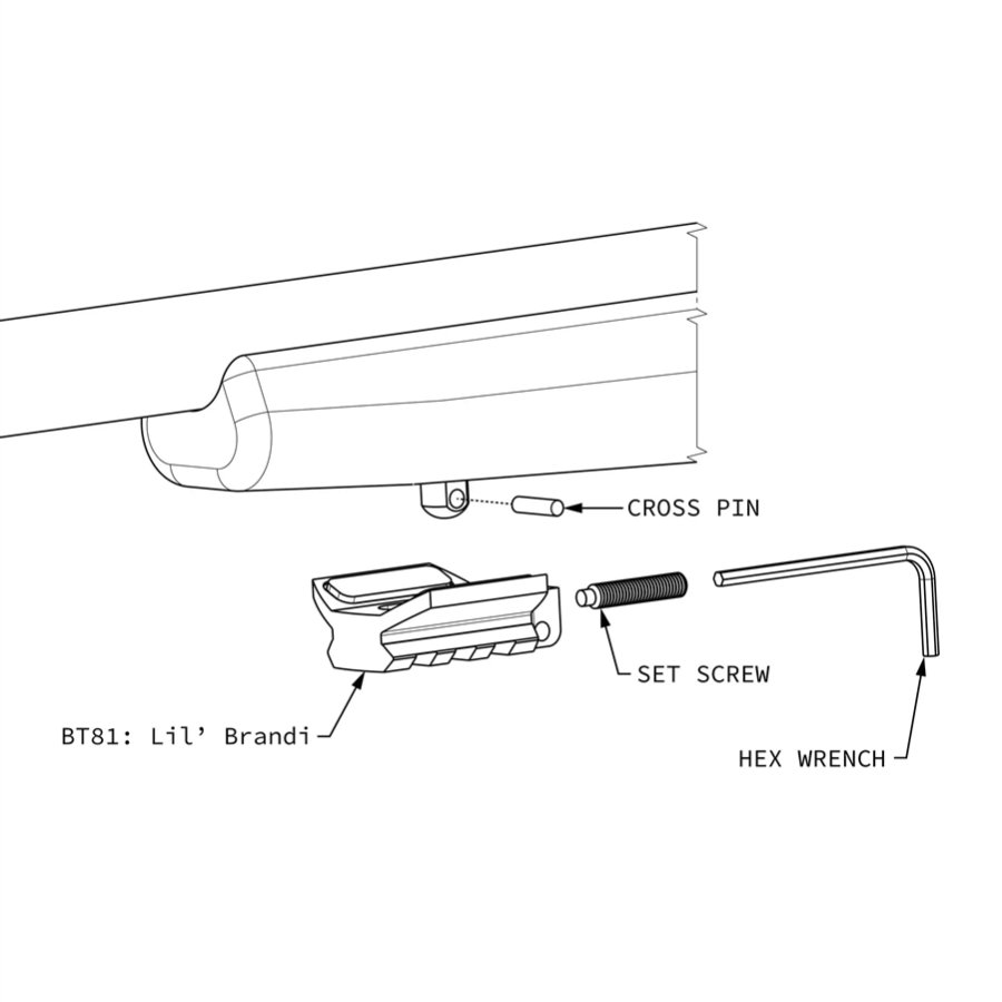

That's a pretty clean take on the problem, I'm guessing that the slot that the cross pin rides on is angles so that it snugs up against the stock as the set screw locks it in place from moving forward?

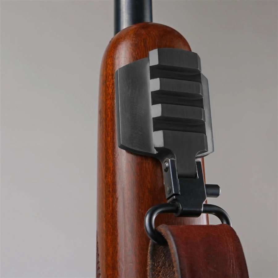

It's interesting that they choose that rifle stock to mount it on for their promotional shot as it looks like the wings are a bit wider then ideal for the contour of that stock..... otherwise it looks pretty sleek.
Precision Optics, can you confirm that it's an angled slot for the cross pin that snugs it on to the stock when the set screw is tightened?

A wee picture of how the cross pin indexes the 'Lil' Brandi' would solve the mystery. For the price, would like to make sure it's a solid mount before picking one up. Though picking one up I would like!

I'd assume the slot for the cross pin would be a backwards L shape (or something similar), allowing the pin to drop into the rail unit, slide forward, with the hex screw from the rear holding the pin forward in the bottom of the slot to keep it tight and prevent it sliding back out vertically. 🤷‍♂️
A straight vertical slot wouldn't seem to hold the unit secure enough for confident sling mounting.

B&T makes quality items, I would expect it to be a simple and rock solid design.... but I agree the pictures and diagram are lackingQ

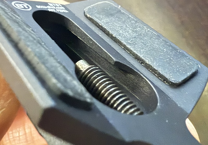

Correct-a-mundo: you spin out the set screw so that the sling stud with cross pin installed can fit into the wide opening in the bottom of the Lil'Brandi. Then, as you tighten the set screw, the cross pin rides the internal slope downward sucking the Lil'Brandi down to the stock. We have not heard of a complaint thusfar.
Yes that is precisely how it works - see attached photo.
