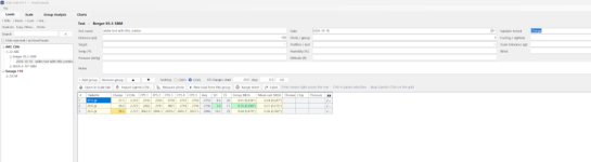

The Program, once completed, I can share. If anyone wants to play with it. it doesn't require the scale. The intention is to combine a couple different parts of my process into one program. I have group measuring working. I see a lot of pay-walled versions of this stuff and I would rather provide it free. The scale uses a DB9 connector with RS232 serial. its pretty easy to set up with a $15 cable. I will probably post or update this when I get the program more fleshed out. For now I am running through testing it. If anyone has any interest in trying it please DM me. I haven't setup an installer or anything yet to make it easily shareable but I will soon. I previously used google drive but I am interested in moving away from it to a local solution like this.
one other thing; The program will/(IS? i still have to test it) be able to parse Garmin CSV files and populate the associated test. I could add bluetooth support but it's not a priority right now.
