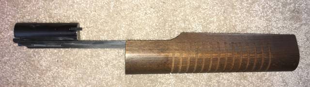

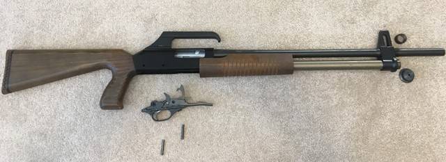

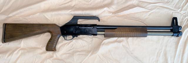

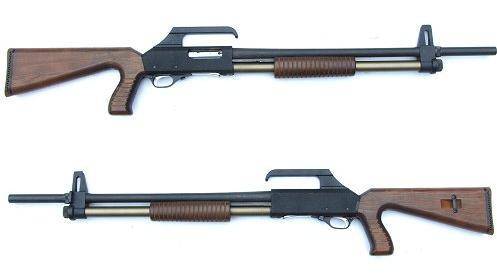

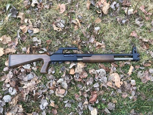

So I did a post on this gun 5 years ago, since then it has spent about that much time in the gunsafe not really getting used. Seemed like it was time to pull it out and take a look at it again, so I took a few pics while I had it out, debating what to do next with it.
These were made in the early 1980s, by Fabarm for Viking, a UK company. This was at a time when pretty much the whole of the tactical shotgun market was made up of only a handful of guns, like franchi's SPAS from a few years before, and maybe the like of a Winchester defender with a pistol grip, there just wasnt much else.
Anyway this gun saw little use even in the UK, with some being sold to police etc, and some less 'tacticool' versions being sold as well in the UK market, but faded away pretty quickly.

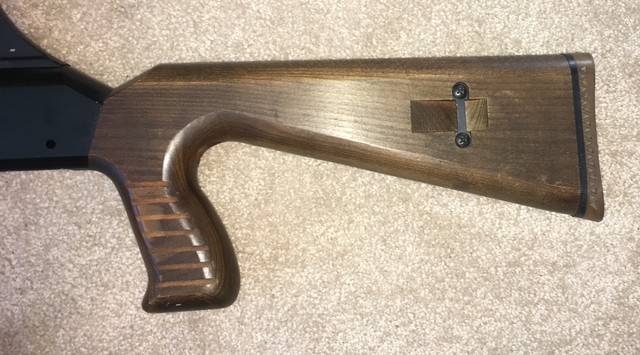

After 5 years, heres what I can tell you: feels good to hold, and does come up on target fast. The pistol grip is probably a little to thick, the wood is Oak, and is fine, the recoil pad area is tiny, the action works fine, the sights pretty good, and in honesty I cant say that the follow-up shots seem to come any faster with this moreso than most other guns (one of the reasons for the high sight line was the lowering of the bore line in relation to the shoulder).
I have only tried slugs and Buckshot out of it, and truthfully that small recoil pad does not make it fun.

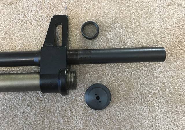

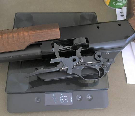

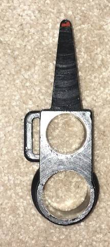

For this much shotgun, a little over 7 pounds isnt bad, with a 24 inch barrel. The front sight block is often shown and illustrated backwards for some silly reason on these guns, its an aluminum casting (like the handle) and the angled side has dayglow orange paint as a highlighter in the top of it.

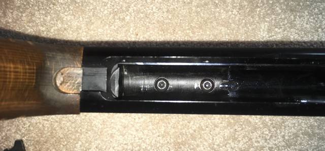

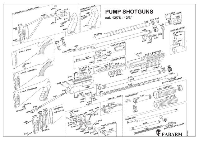

Fabarm used a staked in place ejector, seems less ideal than say a remmy 870, but works, and is easily replaced on the barrel extension
Due to british gun laws this gun, and others I have seen, have been roll crimped to limit magazine capacity to 2, yeah 2 rounds, and it sucks.
Overall without the mag modification I think this would have been a good gun, it feeds and ejects well, point and handles well, and the sights work ok, though obviously are not adjustable. For a gun intended primarily for Law Enforcement it seems ok, but it does seem like alot of machine work for the time, that today we would take for granted.

Regarding the ejector, Fabarm still uses a barrel extension mounted ejector for a reason, as it provides a more solid mount than a receiver wall.
That's easily the ugliest shotgun I've ever laid eyes on
I share that thought, it looks like a plumber made it out of pipes and lumber he pulled out of the basement ceiling when he was supposed to be down there fixing things. Also, that carry handle would snag everything that came in its path, including the owner. But still, it's history and history isn't always pretty. It also maybe provides some insight as to why British shooters have such a cultural hate on for pump shotguns!
I think that’s the first firearm I’ve ever seen with oak furniture. I was always curious why that’s the case, it’s a very strong wood and more than adequate for the application and way better looking than beech. I’m a big fan of quarter sawn white oak.
The curved tip on that carry handle looks like a safety-neutered antler.
