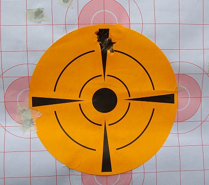

I'm curious to find out what people have experienced in terms of jumping these bullets. I've got a not so hot load for my 300WM pushing 210 VLD's at ~2875FPS but it'll put punch 100Yrds into a quarter sized group.
I'm stuck with a Mark V box mag at 3.385 at the most COAL with persistent feeding problems. I dipped 0.010 down to 3.375 because of this and after shooting the VLD's at ~.140 jump I am more so surprised than anything. The Nosler AB's shot well but not as good as the VLD's.
Thinking it was a one-off fluke I tried again and printed the same result. I have a 270WSM which I can jam VLD's and can't print a reputable group in comparison.
