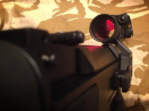

Granted I don't use a wooden stock on my rifle, but so far the newer/shorter CSA side-mount has been nothing but reliable and convenient. Holds zero fine and when I feel like using the comblock sights, I can just pull a lever and be optic-less within seconds.

I like the CSA low mount. It's quick detach so you can take down for cleaning w/o tools like the dustcover mount. It sits a bit high with an eotech, but if you found a low profile red dot you would honestly be fine. The CSA low mount gets really low to the dust cover too.

I found the CSA side mount was a ##### to get locked on right, either too loose and moved around, or another turn of the screw would make it too hard to remove. I went with a railed fore end that allows you to use the irons with the red dot removed.
I got the side-mount and got too annoyed with how it was not perfectly center over my rifle. Being left handed, left primary eye, it would not do. Ended up getting the dust cover version from Corwin and have not looked back since.

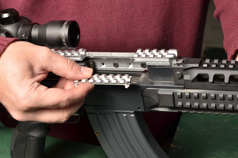

The new Magwedge CZ-TKR
Accessory rail in use ...
You can employ the optional insert rail with the CZ-TKR but occasional stove pipes will be the result. Without the insert rail the CZ-TKR runs flawlessly.
The insert rail was really designed to work in the SKS-TKR where it performs well, but will also fit the CZ. Use with full knowledge of what you may have to deal with.

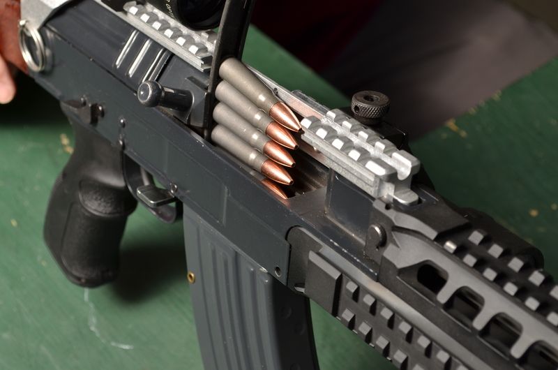

Enables strippers if anyone wants to strip load into the magazine. I mainly included this shot so you could see the open configuration of the TKR and how it avoids FTE issues.
