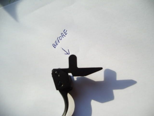

The application of material (welding) to increase the disconnect ramp height
was used/suggested by me at that time, because we were all out of spare parts kits and any other parts for that matter. Since then we have received numerous parts and part kits. If your disconnect spring tension is sufficent then swaping out the bolt carrier is the simpliest solution, the replacement, original military ones still have the angular, pronounced disconnect ramp on them.
Cheers,
Wolfgang.
Could you possibly have a local gunsmith machine a new disconnector that is just slightly longer and perhaps a bit more heavy duty in nature?.
