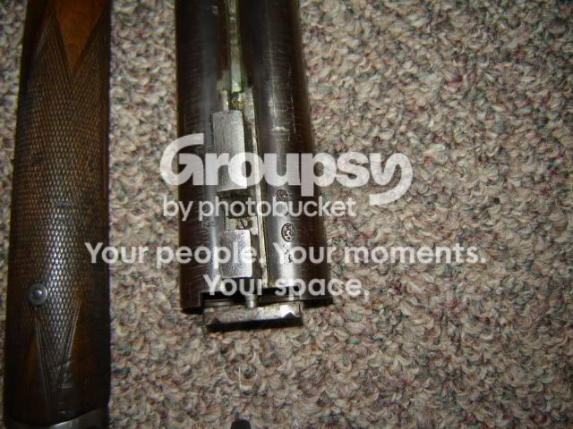

If it hyas proof marks like this then is Belgium.

If you can get pic's of the proof marks, post them please. I've aquired a rather obscure ( I'd think) book called " The Standard Directory of Proof Marks, with WWII German Ordnance Codes " by Gerhard Wirnsbeger. I've got lots of chair time at the moment, I'd enjoy a little puzzle to solve.
