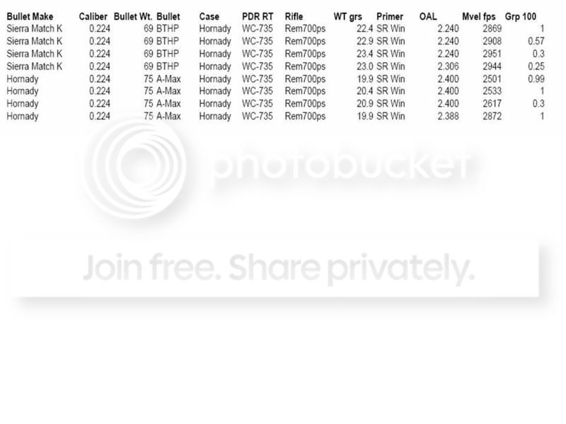

25.5 gr. (19.5 clicks on my Redding 3BR) WC735 (Lot 117)
Berger 50 gr. HPFB Match
Avg. 3,270 fps over Chrony (@90 F) in a Shilen SSSM 20.125" bbl. on a Savage action.

For those of you with Quickload, if you plug in your actual numbers for all of the necessary details, it will get you within 10 fps of actual velocities, in my experience.
