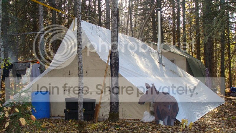

Yup, can't remember the details though. Pretty expensive bit of careless if it hadn't been. these things are supposed to be fire retarded. :D From the moment I spotted a tiny flame on the stove hole cover, which slipped too low and touched the stove pipe, to this, took about 5 minutes. Didn't have water on hand [very stupid], so I just cut the canvas ahead of the flames. Managed to save our sleeping bags.

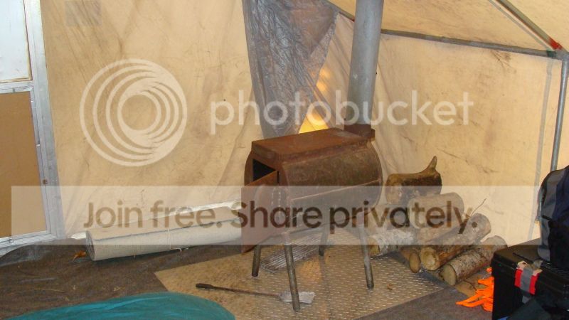

Check out my 'new' air-tight stove.
I cut the end off a barrel...
... and inserted it into the bottom of the old stove. I'm gonna get the welding shop up town to run a bead around the bottom to seal it up, add some legs and this thing is good to go!
The old barrel stove in action, when it had an open bottom.
Edit to add: I'm gonna throw some fire brick in the bottom to protect it from burning through.

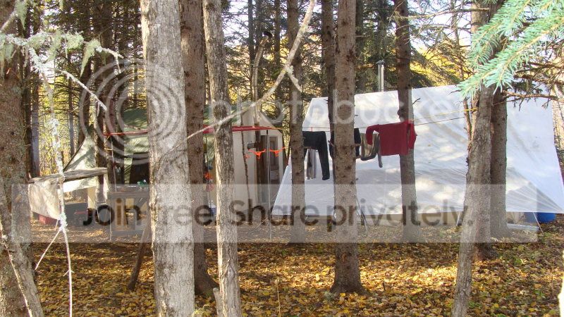

Demonical, here's ours, we just use a dirt floor covered with tarps. I like the steel pole set up, since this pic was taken I bought one for our tent too.

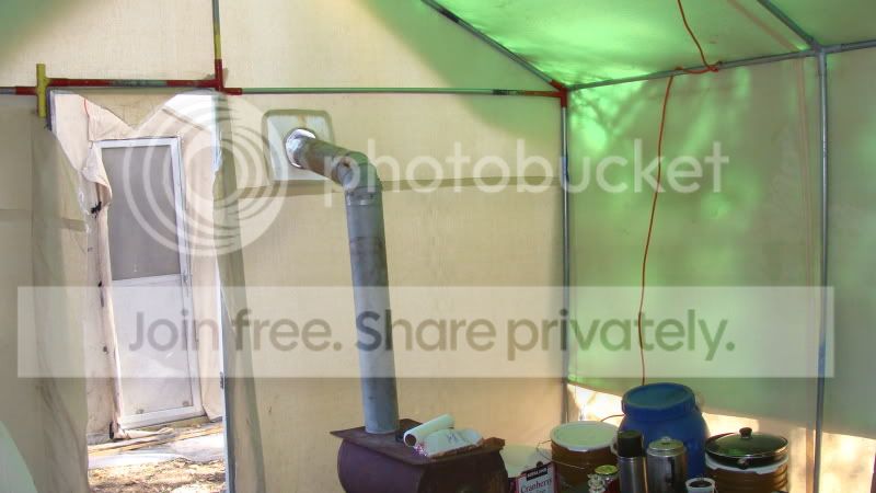

I got my stove finished; had a seam welded around the bottom of the barrel. I made a small stand for the stove.
I'm gonna get a 4'x4' piece of sheet metal to set it on, to protect the floor.
One of my hunting buddies did the inside pole frame set up.
On each end he welded in rings for a cable to run the length of
the upper poles.
Two reasons, to hold the ends tight, turn buckle on each end and
to hang wet clothes.
Bit of a nusiance, but hey, when their wet a bit of ducking is good
for the abs.
Clothes dry real quick.

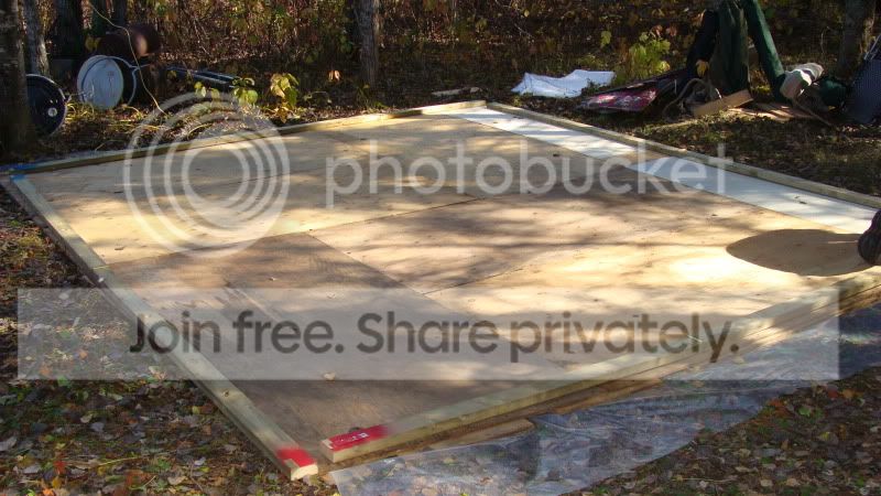

Here's pics of what I built this year.
The floor is 2"x10"x12' planks; quite the chore to haul into camp! I also had a #####-of-a-time with warped boards, Had to use a wedge technique to force a few straighter.

Btw, this stove is friggin awesome, it is sure enough air-tight. Burn all night with the draft shut and the damper throttled.
I put 2" of sand in the bottom; the piece of tin under the stove is for decoration only. It was not needed at all. The floor is completely cool. In fact, what I will do after this hunt, is trim the legs 6"-8"... whatever height is best for access.
