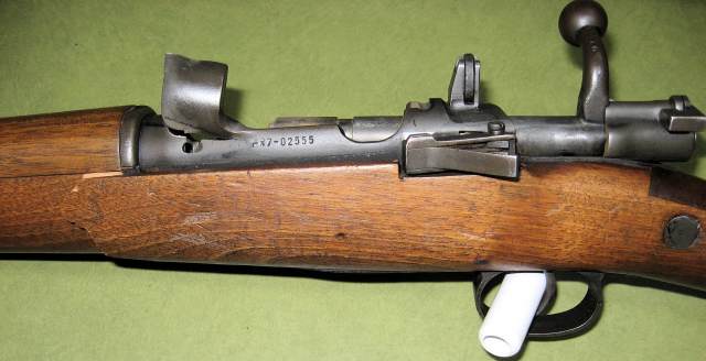

yikes
stick with the beefy fr8 action
yikes
A quick google search on that image and other forums the overwhelming consensus is there is no way a standard 7.62 NATO would have caused a kaboom like that. Lots of speculation. The rifle itself doesn't seem to be the thing in question among this failure.
Fr7 should take 7.62 nato easy. Look how much effort it took bloke on the range to blow up a no4 enfield reaming it to 300wm with that ultra inferior rear locking lug set up thats super weak and terrible.:rolleyes:
