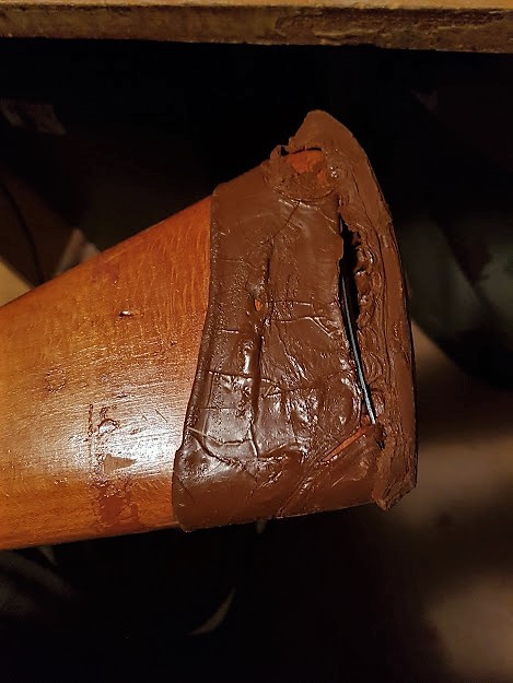

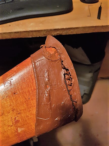

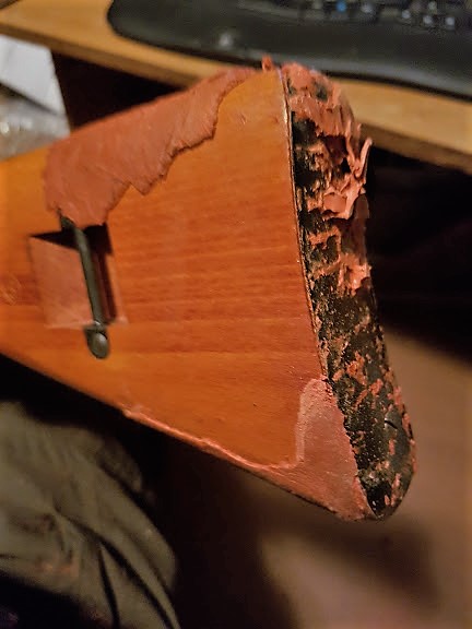

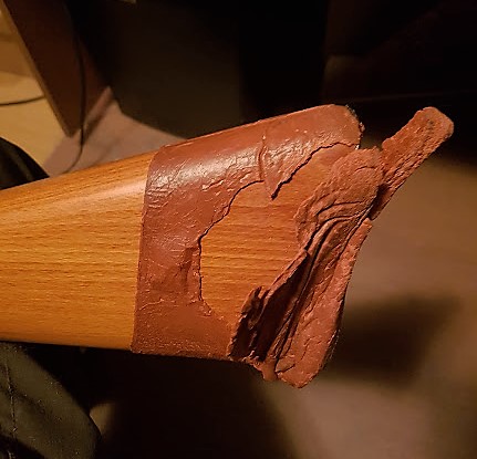

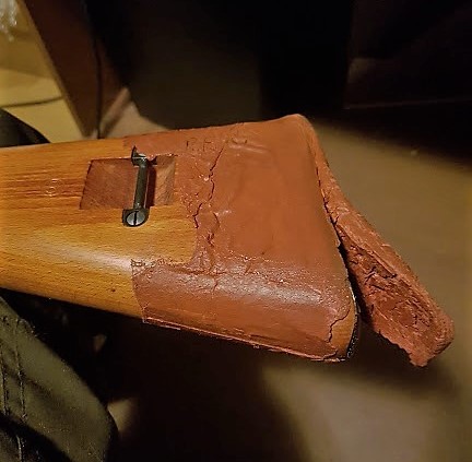

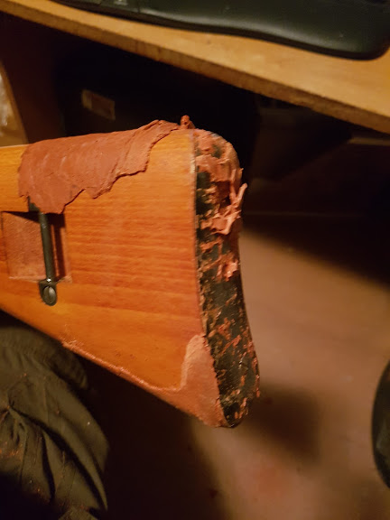

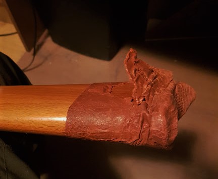

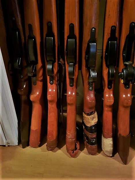

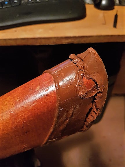

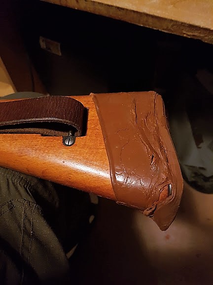

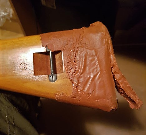

Got these club rifle(s) returned sometime ago with a non issue slip-on recoil butts.
You can see the mess. Will have to take my time getting it off. Can't use alcohol due to original shellac finish on stock.
I'm not saying those recoil pads have anything to do with my statement below, but,,,,,,,

Here's what I would do. Sharpen some popsicle sticks and use them to remove as much as possible of the remaining rubber. Then use WD40 to remove the remaining residue. I've used WD40 successfully to remove a large variety of residues and material without damaging the underlying finish. BTW, it makes a super carbon remover from your rifle bores as well.
Hmmm, my Mas 36/51 is wearing one of the military issue rubber butt-pads. Has anyone seen this occur with those? Maybe I should keep it off when not in use.
I can't remember if the K31 has a steel or plastic buttplate. If steel, it's probably wise to remove it, as it could trap moisture.
