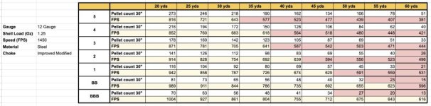

So long story short decided to give my shoulder a break and move from 3.5" to 3" shells, thought BBB would be best, bigger is better right? Then I say a choke "Ted Talk" by the Muller guy and he mentioned BBs and BBBs dno't have tight enough patterns and you just cripple birds. I'm not gonna lie half our Canada geese are cripples :cry:. This brought me down this rabbit hole of figuring out the best shells based on math and theory.
Of course nothing beats patterning your shotgun, but some interesting numbers. In short, I think he's right. #1 is probably the best shotshell for my scenario, although BB looks good as well... BTW these tables are completely dynamic, I can change load size, speed, pattern numbers, or even add a custom choke with real world pattern numbers for better accuracy of your setup.
Red cells are under 600 fps or less than 30 pellets in a 30" circle (ethical baseline)
If I can figure out how to lock and share the Google Sheet I will share it so you can run your own numbers.
The Ballistic Calculator on this site is also very useful https://www.kentwildfowlers.co.uk/homeframeintro.html?https://www.kentwildfowlers.co.uk/chokes.htm

Again the point of my post is just to discuss the base numbers, and the math behind patterning and energy. AND 100% nothing beats actual patterning.
Also these numbers are based on the longest range, but shooting over decoys, never taking a shot past 40yards then you can do better with a load that has more coverage, say #3 load with a cylinder choke. Much better coverage at those shorter distances and still have almost 600 fps at 40 yards and keep a pattern past 45 yards... In Theory...
There's a balance between load size, shot size, choke and energy. And some loads just don't make any sense. I can't think of any situation where you would want to shoot a 2-3/4" BBB shell for example
Similar to the balance of light in photography with Aperture, ISO, and shot time.

100%. That's what I also discovered in this deep dive. I'm telling my hunting buddies no BBB and T is not the solution to our missed shots, it's the opposite. But they don't want to hear it. Well fine, sold them my 3.5" BB shells and bought 3" #1s lol
The Federal are patterning well but next year when I have more time I want to try more brands and get the best pattern and shell options. I also want to buy the kickoff for my A391. AND also practice more shooting, shotshell doesn't matter if the pellets aren't in the right place...
