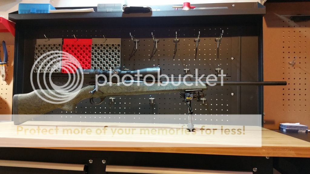

OK. So I learned something....I'll let the pics tell the story. First is a Howa in a Hogue, next is the Flamer Vanguard. Bolts are the same length, it's the stock that is limiting the amount of thread grab.

Mine's like that too. Mine is the Kryptek Typhon, but the same style stock. I wonder if the standard S2 stock has the same problem?
Nice paint job by the way.
I'd almost be tempted to put a drop of Lock-tite on the top side of that thread and
let it cure before shooting.
Might just be enough to hold it without further reprocussions.
