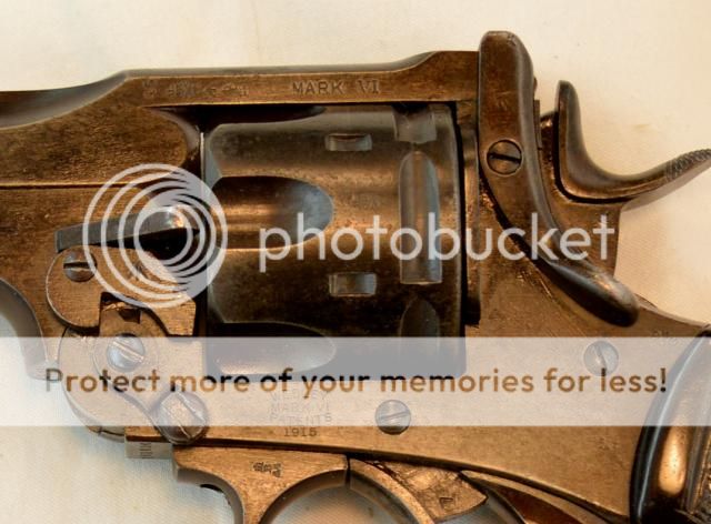

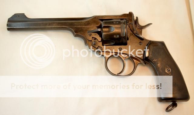

Webbley
Thanks for sharing. I sometimes regret that I don't have mine anymore but I wasn't going to shoot it much and I know it went to someone else who deserves a turn.
Thanks guys, for your fine comments.
I once had another MK Vl, very similar, but I also had at least two 44 magnums and a 357 at the same time, so I sold the Webley. Now, I appreciate the Webley more and its history.
I did reload for the Webley when I had the other one, and yes, I am going to reload for this one. I can't find any notes from before, but I will use a fast powder and the chronograph, to keep the loads low.
