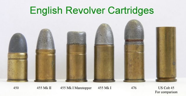

It been converted to shoot .45 ACP? Webleys didn't come in .45 ACP or Auto-Rim. Webley's came in .455 Webley, et al. Used a different bullet diameter than the ACP. .454" vs the .451" of the ACP/Autorim.
In any case, the .45 Auto-Rim is literally a rimmed ACP made for revolvers chambered in the ACP. There's Autorim data on Handloads.com.
If you have a Webley converted to .45 ACP, just use .455 data in either ACP or Auto Rim cases.

As has been mentioned, it's highly unlikely yours is 45 Auto Rim, unless of course someone has it "bubba'd" and that wouldn't be a good move because of the difference in bullet diameter.
I'm just starting in to reloading for mine and have just lately picked up, through a guy on this site, some 455 Webley brass made by Hornady. The bullet I'm using I get from a local guy. It's 260gr and looks very much like the Lyman # 457196 in the scan below, top right.
For load info and the bullet scan above I got from an old 1st Edition of the Lyman Book of Cast Bullets. I'm going to try and come up with some loads using Trail Boss, ;)when I get the time.

I was hoping to at least try my standard .45 cast bullets from Bullet Barn as I had read that some folks had shot similar slugs successfully. (However, I've also read that some folks have repeatedly put standard .45 ACP loads through theirs without incident, much against the advice of many more experienced Webley shooters, GrantR on CGN being one of them) However, while taking the old girl apart for cleaning a few minutes ago, I decided to measure the cylinder mouths and they miked at .445. I'm feeling reluctant to push a .452 hard-cast slug through that in a 90+ year-old revolver.

Great insight as to the Metford rifling, I was quite relieved to know that it was just the design of the rifling that gave the lands its rounded look & not an incredible amount of wear. As for the .452, it being slightly undersized should not cause damage to your webley, although it will not have as much potential for accuracy, than if you used .455 or some hollow based .45 lead

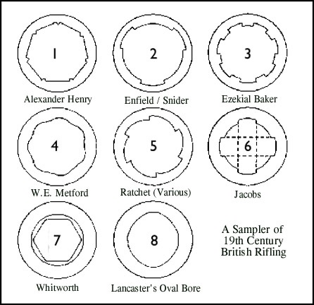

It turns out that I was correct about that - as regards your Mk I revolver - but I think I suggested that "Webleys were Metford-rifled" based on reading Skennerton incorrectly (I don't have it at hand at the moment). The Metford rifling was replaced by Enfield rifling sometime after they switched to Cordite, as the new smokeless powder eroded the shallow rifling quickly. There is an interesting article on Webleys at:
www.imssu.org/articles/Webley 455.pdf.
and a diagramme showing both rifling designs (from the original armourer's drawings by the look of it) here:
www.martinihenry.com/images2/enfieldmetford.jpg
Given that, I'd think you'd want to shoot black powder only in yours, or possibly an equivalent such as Pyrodex, but it would be wise to check if Pyrodex is safe with the old rifling. I beleive GrantR here on CGN is something of a Webley expert. Maybe send him a PM.
:) Stuart
Mk1 rifling looks like the image in 1st column 2nd row.
Blimey! Exam time for CGN'ers: Identify these rifling types and give examples...
I'd be interested to know where you got the diagramme, too. Might be very useful.
I'm pretty sure that the rifling in Row 2, Column 1 is Metford. I think the polygonal one below it is Whitworth, used in the famous Whitworth target rifles in the mid-19th c. The only other one that I'd be willling to guess is the one at the end of Row 2, which looks like the belted bore used in the infamous Brunswick Rifle (hard to load and excessive recoil, apparently) from the 1830's, which used a belted bullet, although it may have had only two grooves.
