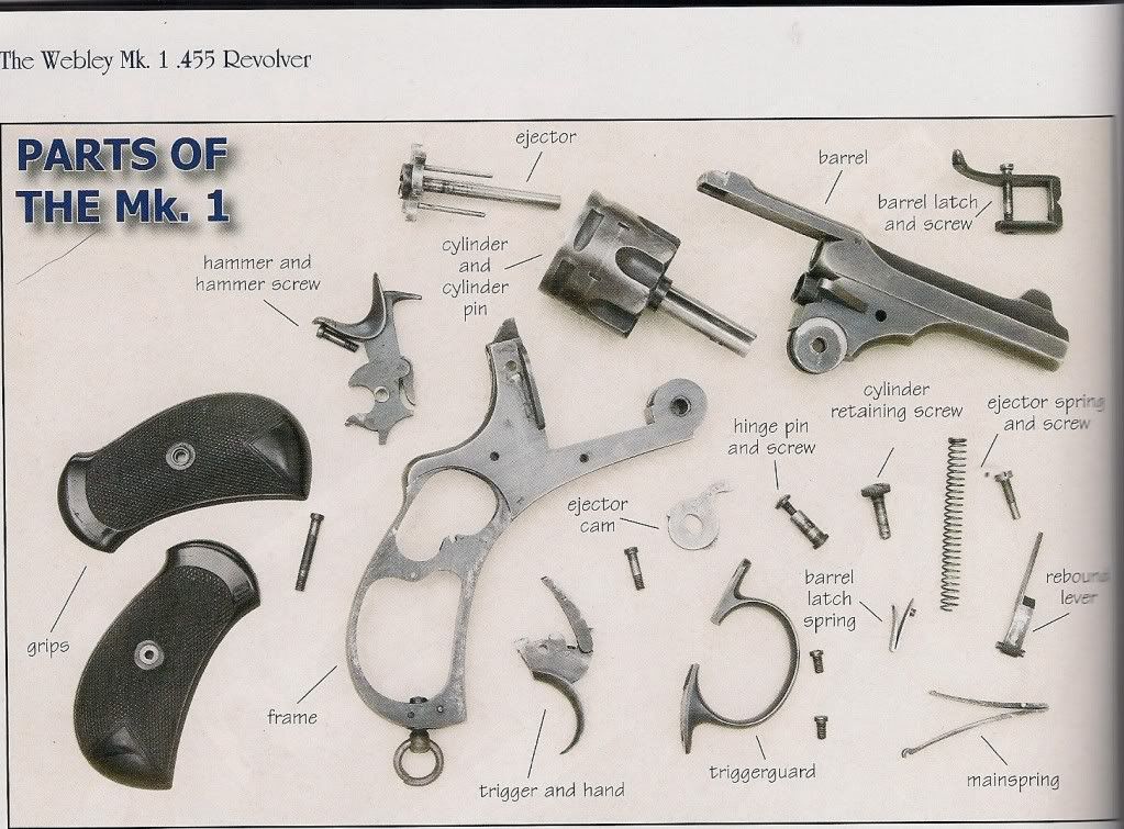

Does this help any?
Yes it does tokguy, no such thing as too much Webley info, eh?.:
That page has been put to favourites, thanks.
That is neat.
Didn't know that they had that few parts.
45 parts to a MK1, MK1*, MK11.
