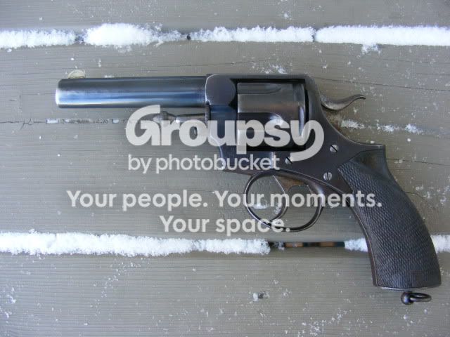

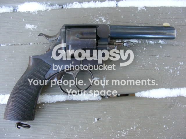

Just got a new (to me) antique Webley - an RIC#1 .476/.455 with fluted cylinder in excellent+ condition.
It's slightly smaller and lighter than the MKI/II .455 service webley. It points very naturally and feels really good in hand. I'm dying to get out and shoot it, but i'm waiting for the weather here to get above -10 at least.
Anyone ever had their mitts on one of these? How did it shoot? I've seen and owned a few RIC models in .450, but this is my first chambered for .476/.455. Pics to follow.

Here's the pics. Yes, that is real snow.
