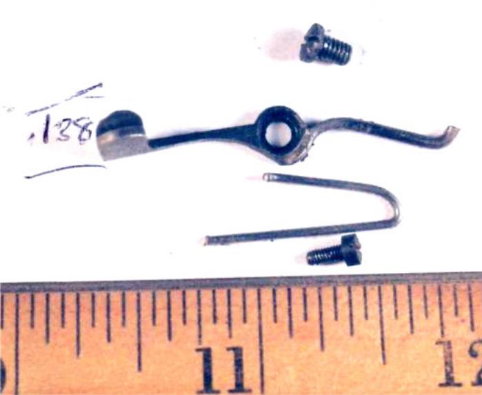

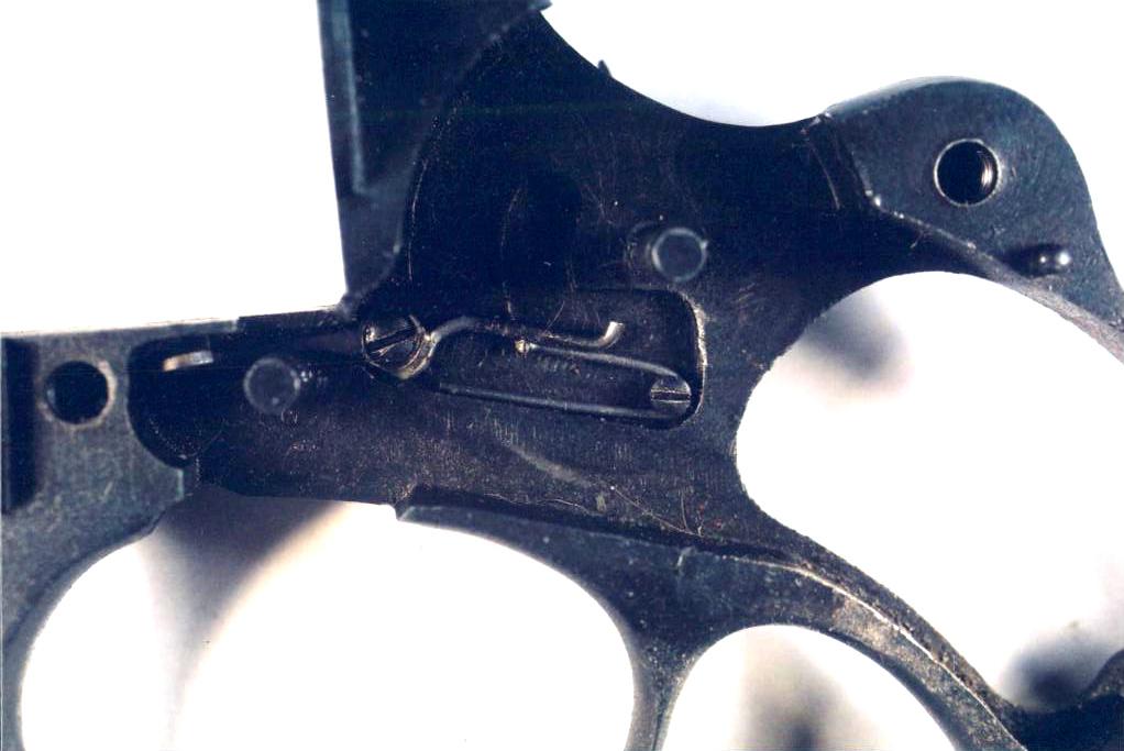

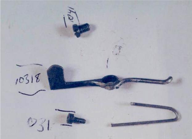

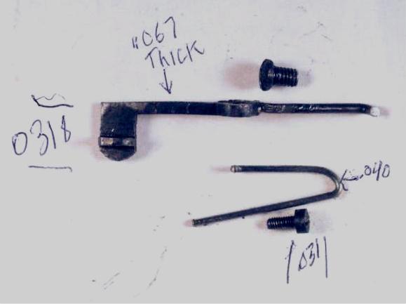

Sounds like you could have what are commonly encountered issues with either your Cylinder Stop, Screw and Spring! You can easily get to these fragile parts to check them by first removing the screws on the side plate and the grips and then gently prying the side-plate off!
They are probably the main weak links in these otherwise excellent revolvers! Replacement parts are basically non-existent and will need to be hand made!

This what it should look like, pictures courtesy of John Sukey -
