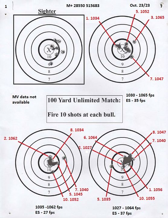

I don't doubt that what I'm going to describe happens to just about every .22LR shooter. There may be some very good lots of .22LR match ammo, the ones that do what's expected (with a very good rifle, of course), but I've yet to shoot one.
Usually a round ought to go close to where its muzzle velocity predicts. Faster rounds have a higher POI than slower ones. That's what makes sense.
Yesterday I shot at 100 and it was quite calm -- at least until I began shooting a second 100 rounds at a second set of targets. I chronographed the rounds but was unable to get the first ten because the chrony sensors needed attention. I used two boxes of Midas + for the first ten groups.
What struck me was the MV/POI mismatch that occurred in every group. For example, the round with the lowest POI on the top right bull top right bull had an MV of 1047 fps, right in the middle of the ES range. The same kind of thing happened with every group.
It seems obvious that some rounds don't strike the target according to what their MV predicts.
To be sure, many rounds do have POI that match their MV, but some rounds strike high for the MV, some rounds strike low.

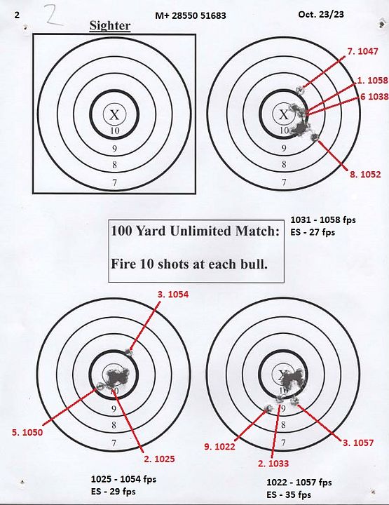

Below is another target that shows this impossible to anticipate behaviour. In the top right bull, for example, one of the group's fastest rounds had the lowest POI. With the bottom left bull two rounds have side-by-side POIs yet one is 25 fps faster. In the bottom right bull the same kind of thing is seen.
I guess this is why they would want would to shoot 'lasers' instead of real ammo at Olympic competitions... I would prefer real rimfire ammo that's actually good though.
These are the reasons I would love an electronic target but definitely not in my budget.

you're acting as if every soft, bare-lead nose of every round is the same as well. Just because it gets launched at 1047fps doesn't mean it will slow down at the same rate as the next projectile. The iMV is more about mass weight then aerodynamics. It won't effect the bullet much after 18" of acceleration, but it sure will on the 3600" it has to travel to the target.
Here's one more example. This group, shot with Center X, has a very wide extreme spread of 1030 - 1069 fps. It might be expected that the fastest or slowest round could be an issue.
As it turned out, both the fastest and the slowest rounds were somewhere in the middle. The lone high flyer was 1040 fps.
You should be aware that the behaviour of rounds that are "perfect" is predictable by means of ballistics calculators. The rates at which they slow down, drop, drift etc. are calculable. If these things were unpredictable, no one could shoot much of anything with accuracy.
Of course shooting outdoors is never completely predictable. Yesterday, while shooting the targets shown, the conditions were as calm as I've seen them.

grauhanen, Were your shots at 100 done with 'cooling time' between shots ? I noted in the first set of groups a couple with 'same mv' hitting at opposing heights, with 10 or 20 rounds (depending on your target sequence) between them. Short time gaps causing a warmer barrel effect due to diff viscosity or moistness of lube or thermal expansion of the barrel ? jaia has at one time suggested that 'moisture effect' as a possible variable . I don't recall if he had substantiated that or just posited it.
