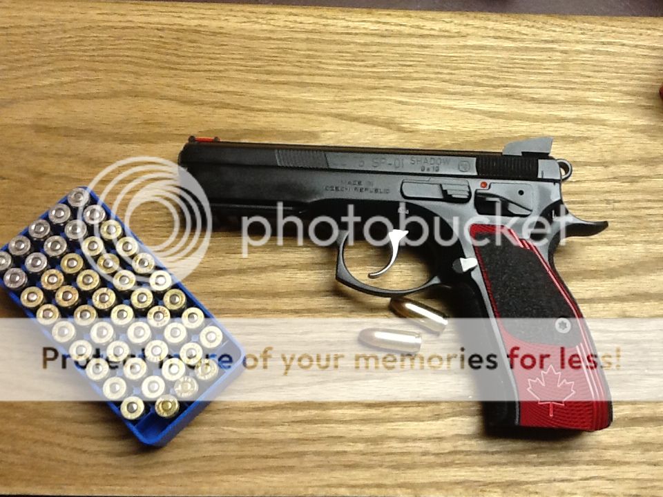

Is that the same grip I ordered? It looks identical, except for the engraving. It does say in the description that one side has a maple leaf.

Here she is. I think I'm going to leave the internals as is for now.
