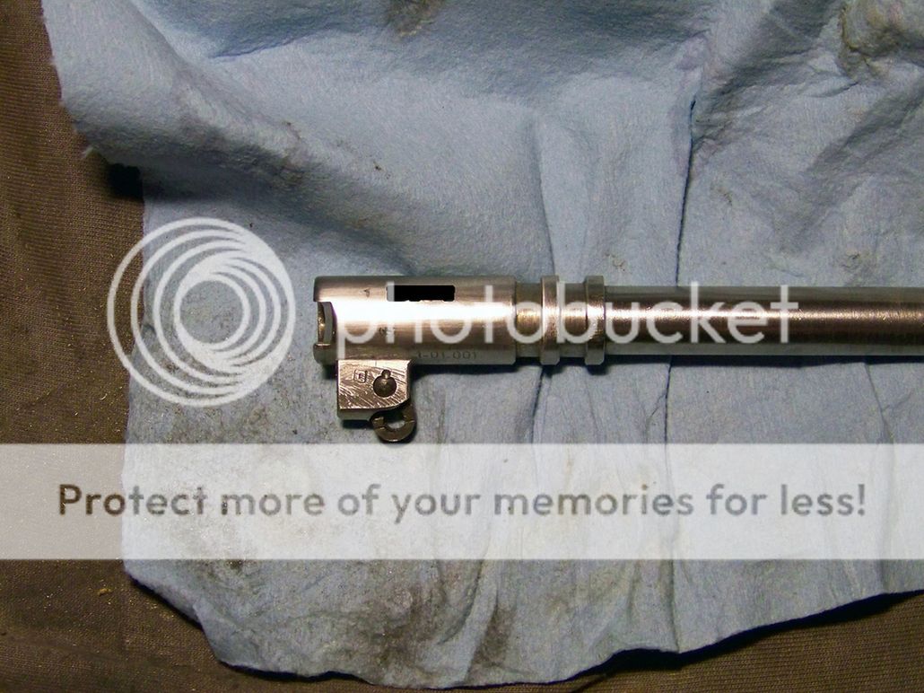

Ok so I trimmed it a bit, smoothed the peened part and went back shooting today. I encountered the same problem but this time it was after 160 rounds instead of 12. It wasn't as bad as the first time though, so I guess I did something right.
I went back and filed some more. Here's a picture of what I did, so everyone can understand. The part that's shown as to have been removed was exaggerated so you can see it better. In fact I probably removed less than half of that.
When the slide is closing, the extractor was hanging on the part that's now removed, instead of sliding smoothly, deforming the corner like shown on my first post. I trimmed it slightly again, hopefully it will not hang up on the extractor anymore.
Here's the same picture without the lines, showing what the barrel looks like now.
