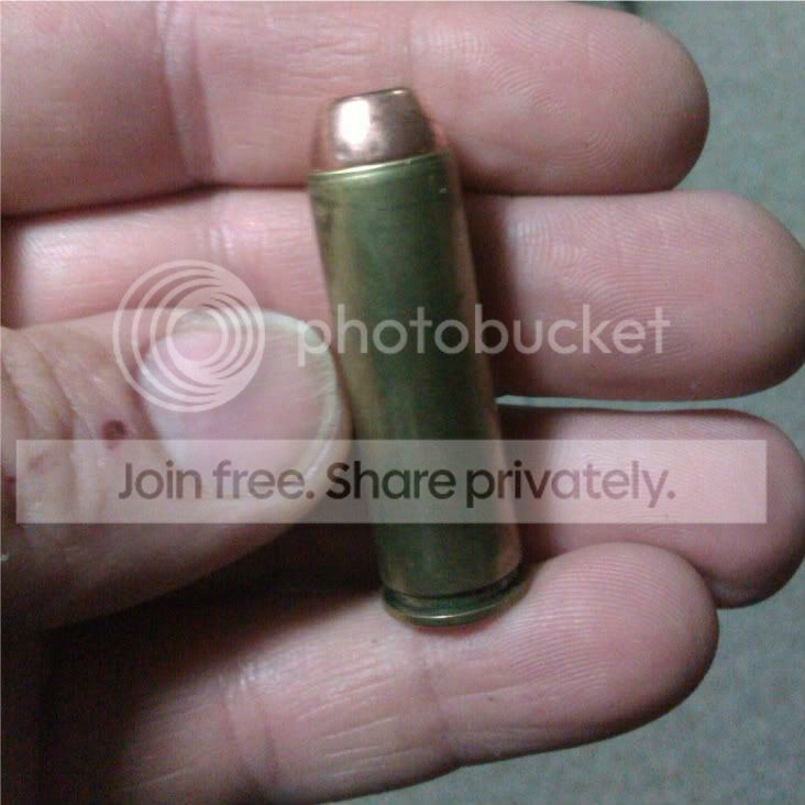

I regrouped, seated the bullet to an appropriate depth (about 2" COL) and gave it a good solid crimp.

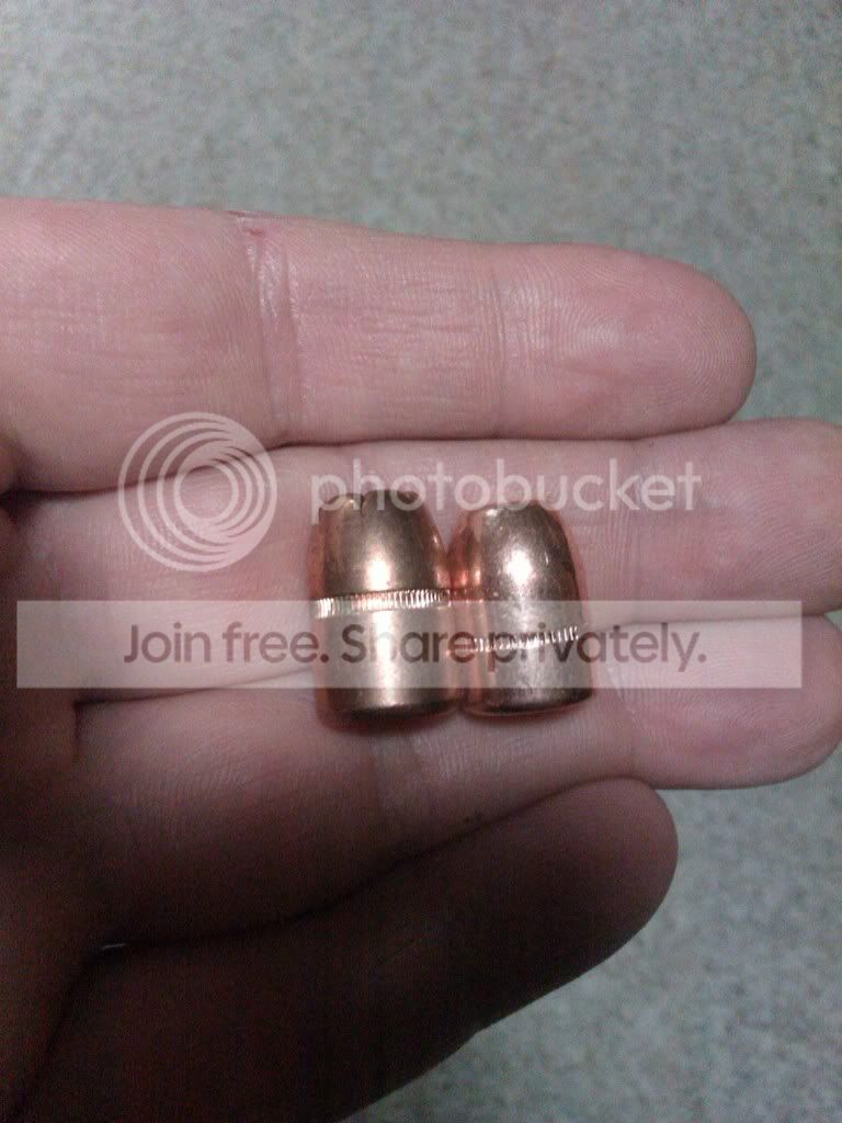

On the left is how I loaded it initially, on the right is the 2nd attempt:
Went to the range last night, first shot, poof. This time it lodged the bullet about an inch into the barrel so it was easier to remove. But the powder again didn't ignite. It all poured out, yellow/green colored. The powder is definitely not bad because the same powder throw was used back to back to load 50 rounds of 50AE which ran flawlessly yesterday.
