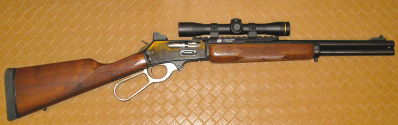

Even though it's a lever action this setup works really well for deer and black bear hunting in the thick stuff and rain of southern BC.

I had my Mod 0 set up as a Scout for quite some time.
A little on the heavy side, very accurate, powerful, versatile and reliable.
I set up a Win 94 carbine and an M98 Mauser as "scout rifles" with B-Square mounts @20 years ago.
I didn't like the extra weight on the M94, and the M98 never did have a fair shake as the mount was so crappy.
I ended up getting a 3rd hole drilled for the receiver sight on the M.94 to move the sight forward enough so that the aperture didn't catch on my thumb nail anymore.
As to shortening an M14 barrel, I've never understood the facination with shortening the effective barrel length on anything~ shortening the flash hider, man that is another story...
looks nice, but what is "a little on the heavy side..."?
after humping (stumbling and cussing) thru the bush (and logged off debris) for a 5 hours in -20, my 6lb model 64 was way too heavy..
