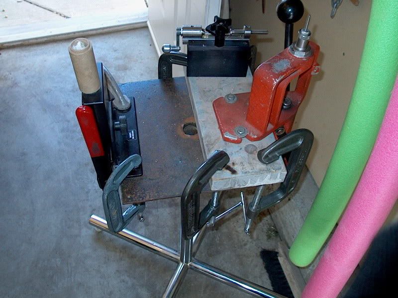

I use an old Pacific 007 (Hornady) for the heavy stuff like forming and a Hood for reloading, both set up for flat surface mounting with c clamps. The Hood takes both the screw-in type dies and has an arbour press on the side for seating or sizing with straight line type Wilson dies. Wilson case length trimmer, all mounted on a old bar table with the top removed. This setup is for reloading at the range, in the RV, in the garage, in the basement, were ever you want to put, occupies about 2 sq ft of floor space.
