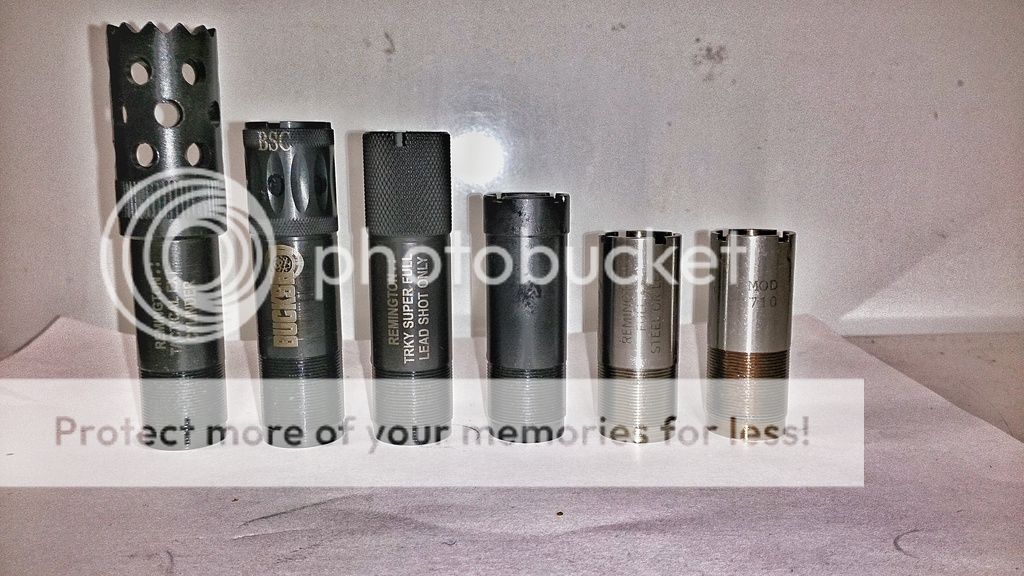

If you guys are looking at extended chokes but don't want the length of a breacher, I just picked up this Buckshot one.
I recommend trying an Urbino out first before buying, if possible.
I currently have one that only lasted one outing, due to some vicious cheek slap. Its now unfortunately been delegated to the parts shelf. They look cool, are good quality and shoulder nice...but it ended there for me personally.
What brand is that extended choke?
Exactly how far past the muzzle does it extend? (please measure)
