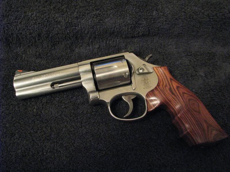

For what it is worth, the wood Hogue grips are thicker than the rubber Hogue monogrips. I have set on an N-Frame and really like the way they feel compared to the thin rubber grips. Note that the Hogue fit is not ideal for everyone. If you are shooting relatively light loads, it is a non-issue. If you are shooting heavy loads, and the grip does not fit you well, it will really pound the webbing between your thumb and forefinger. I find this particularly bad for me with the rubber Hogues and the 4" 629. The closed back Pachmayrs and new factor S&W rubber grips are more comfortable to shoot for me.
Here are some wood Hogues on a 686.

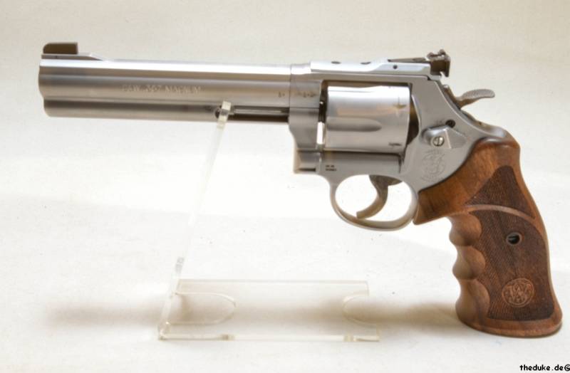

If you want the best wood grips for big hands and are willing to pay, look no further than Nill grips with the closed back.
photos not mine

first choice is Nill Griffe from Germany, have one Nill grip on my 686-4 and are the best, shipping from EU is a lil'bit expensive...h t t ps://www.nill-griffe.com/Replacement_Grips_with_open_back_69.html
