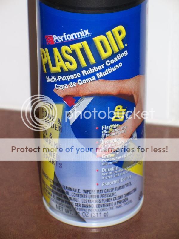

I used this on the chrome trim around the edge of the grills (my car has 2, upper & lower).
Two months and many rocks later, no chipping... This stuff is awesome...
I'd 3M scotchbrite the intended areas, and tape off the push-pin/bolt-holes & any mating surfaces.
And use light coats, this stuff seems fairly thick compared to "spray-paint" (but way more durable)...
Available @ most auto-parts retailers (Autozone, NAPA, etc), comes in spray or 1qt can.
