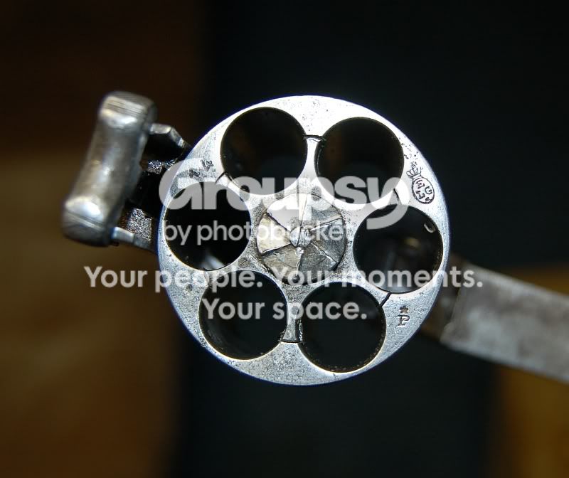

...The prerequisite fashion show:...
I gather the Crown over ELG Stamp indicates the Black powder proof. I gather the Star over P is an inspection stamp from Delcommune Adolphe between 1952 and 1960 and it appears on the cylinder and right side of the frame just back from the barrel pivot. The "14" stamp I'm at a loss for... My guess is a serial/batch number perhaps as the frame also has a 14 stamp on the left side of the lower grip area and the barrel has it on just above the pivot tabs.

The elg with a crown above it also means it's made in Belgium sometime after 1893
yes,and lack of the crown over R that was introduced in 1894 for all rifled barrels would indicate 1893/94 as year of production.
the star over P is an inspectors mark,can be any letter.Used from 1877-present.
this is a good reference for Belgian proof marks:

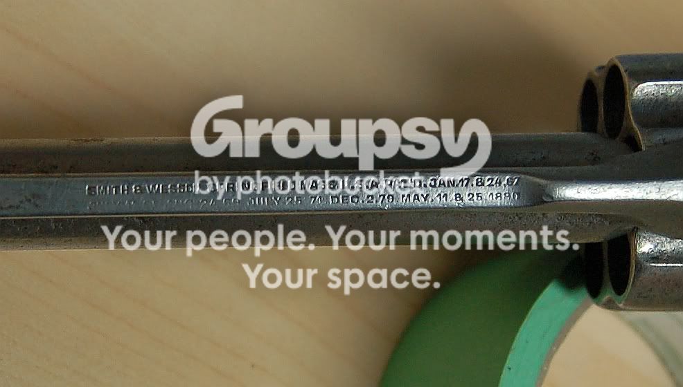

FYI it's a copy of a S&W First Model Double Action in .450 Adams.
The barrel address is even correct save for the last date.
