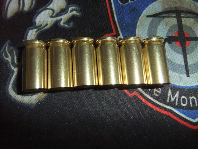

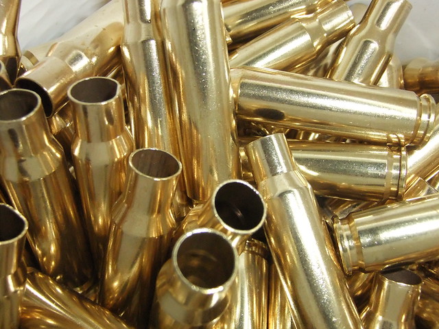

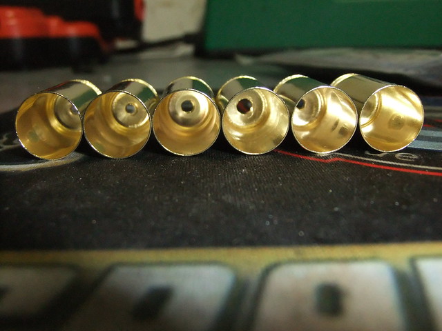

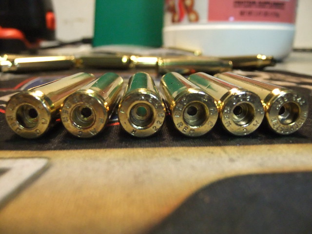

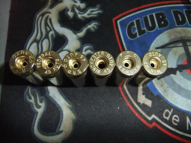

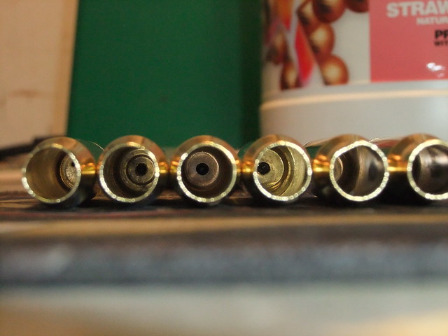

I gave up on vibrator media a long time ago. I switched to ultrasonic cleaning, but more recently i have switched to stainless steel tumbling.The best system going and makes priomer pockets like new.
http://www.stainlesstumblingmedia.com/
Why bother with dusty and messy corncob?

I'm very impressed with the cleaning ability of stainless media. It looks awesome. I have washed cases by hand and depending on the humidity, time of year, whether the heating is on etc, I generally found that using a hair dryer was necessary to ensure no trapped water.
Also I like to quickly tumble, primers in place, before I size, this would make water removal more problematic.
Again very impressed with those case necks and primer pockets.

I'm far more impressed with the cleaning ability of the stainless as displayed, where as the vibratory with the standard medias leaves too much residue on the cases for my taste.
I'm looking forward to trying the stainless media.
