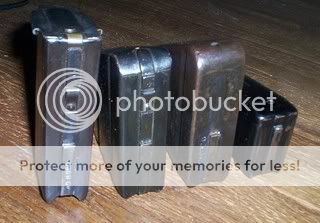

From the left
RFI 2A1 12rd -7.62nato
SMLE Mklll*
No4 Mk1*
Brit 5rd
Hi. A No. 1 mag has two locking lugs on the back. A No. 4 mag has one. Timberlord's dandy picture shows it well.
"...had no troubles fitting a No. 4 mag into an SMLE..." No reason you should. A No. 4 mag will lock into a No. 1, but a No. 1 mag will not lock into a No. 4. They are not interchangeable though.
