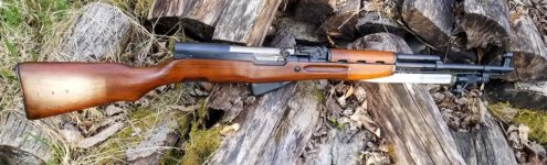

Looking for some inspiration here. Yep, I know guns are all different beasts, but hoping there are some clear winnes haha. Its interesting to find out.
I've got a Chinese blade bayo SKS here in great shape. Shoots a 6" 10 shot group with Chinese surplus and I am sure thats mostly because of me and not it. Problem is, it does noticably worse with PPU soft points and one load I tried with Speer gold dots. Forgot if it was N120 or RL10x I loaded those with but like...Big ugly 5 shot group.
Did about 4-5" with Barnes 123gr TSX.
Obviously it has preferences.
Have you guys ever noticed a certain load tightened things up for you at all? Either way I am absolutely not worried about hunting deer at 100 yards tops with a 4" group. People do it with iron sighted 30-30s all the time. Just curious.
