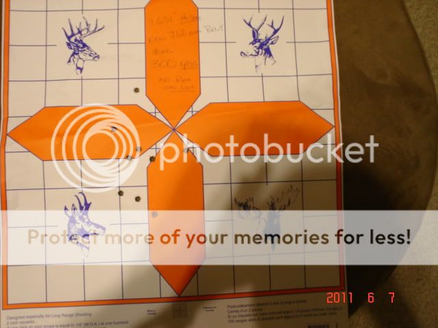

That target was 300 yards, resting on a bench, open sights, perfect conditions, with my new USGI bolt.

Ya, but that was kinda cheating. I wanted to see how the gun could shoot. So I had the thing benchrested. Elevations and windage all done through screws and knobs, near perfect wind conditions, careful resighting and barrel cool down after each shot.
Almost had a string pulling trigger too! It did illustrate to me that the rifle is indeed a shooter and that was the whole point of the exercise.
