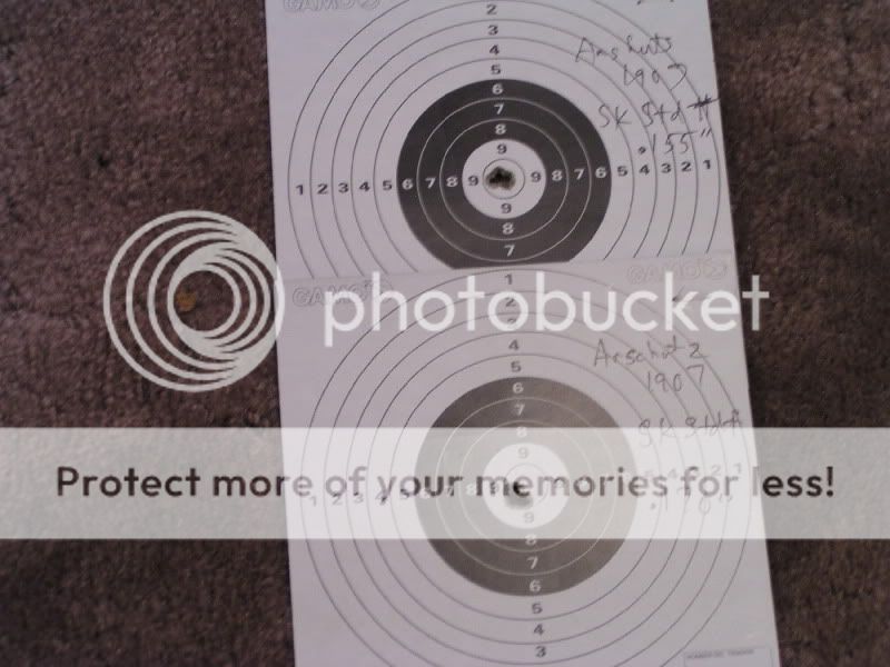

Below are two five shot groups fired at fifty yards using SK Standard Plus in my Anschutz 1907 repeater. In perfect conditions, the majority of groups with this combination are in the 1/4" range at fifty yards, and under 3/4" at 100 yards.

Looks like I pissed my money away on an Anshutz prone gun and Eley ammo. I am going to have to wave the :bsFlag: on that claim because with groups like that you could win the Canadian Smallbore Championship.

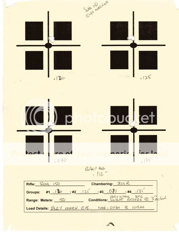

Suhl @ 50M 10-shot groups, shot on a very calm morning. [Eley match EPS]

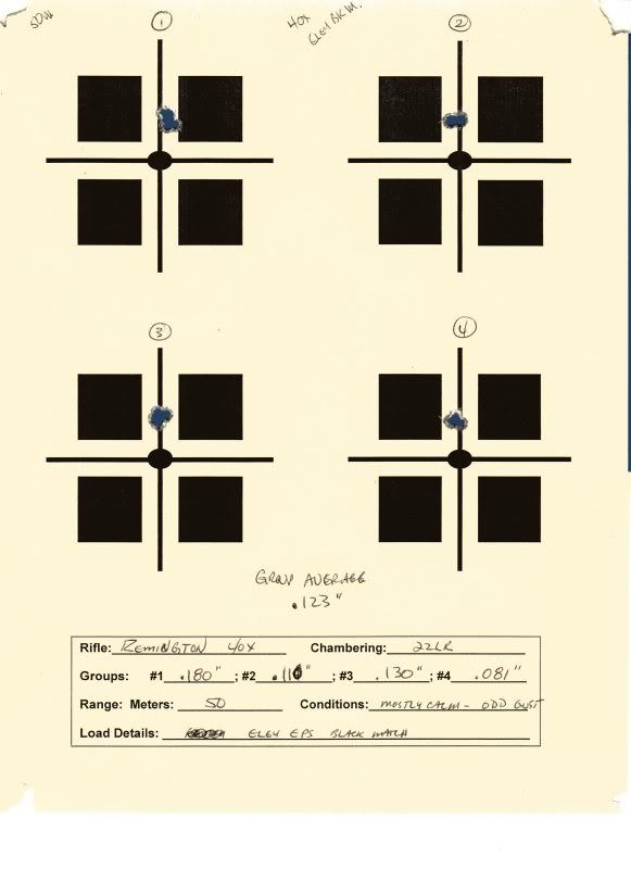

40X @ 50M also shot on a very calm day. [Eley match EPS]

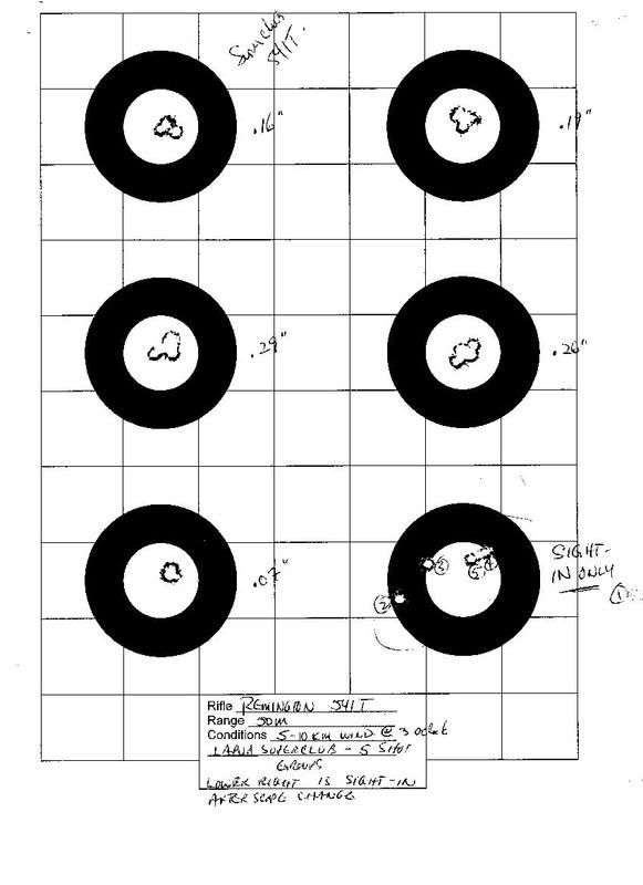

Remington 541T @ 50M some slight wind, but generally calm [Lapua Superclub]

Eagleye, I have to say I truly enjoy your posts, and the pictures of your targets. Very few really understand what it takes to get 22's to shoot anywhere near what yours do on a regular basis.
The Zero on the 150 on the side of the suhl in the picture is what this suhl regularily shoots at 50 yards (5 shot group)

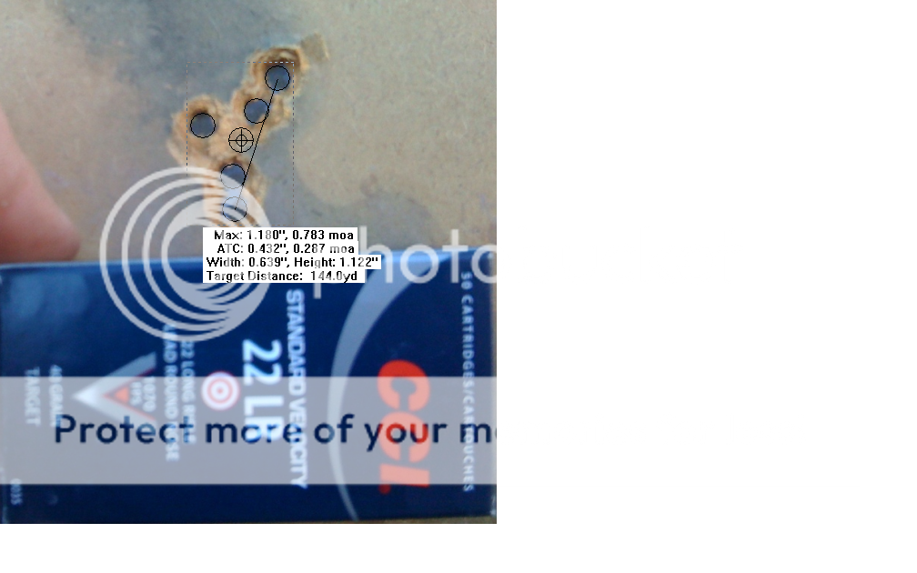

This is the best I have attained with my 10/22. This target was at 100 yards using bulk 333 ammo, perfect day (no wind). The rifle is a 31 year old Ruger 10/22 standard carbine with a Timney Trigger I got from Jerry at Mystic. The scope is a Burris FFII 3-9X40. There was 1 mulligan (flyer) that is hiding under the ruler at the 3.5" mark. Ever since this day, I have been lucky to hold 2" groups with the same rifle. That group measures about 1.18" with the 9 rounds.
