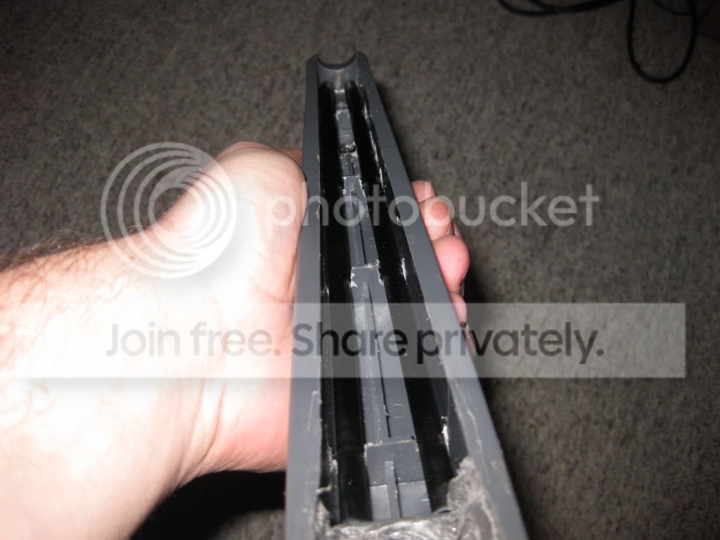

Which liquid epoxy would be free flowing enough to fill in all the gaps and be able to stand deflection without cracking and be somewhat light?
Here is what I'm trying to epoxy

It's a stevens stock and it's gonna be my coyote gun, just looking to stiffen the forearm a bit. The thickest spot will be 17mm and the thinnest will be 10mm I only want to go 1/16th of a inch above the carbon fiber shafts as that will still give me 1/8th inch clearance between epoxy and bottom of barrel.

I was going to check out Hobbyworld last time I was in Stoon but didn't get the chance, I guess after Christmas I'll have to go there. You suggest just slathering the epoxy into the channels then putting the rods in place and adding some more on top? Will the epoxy settle out into a smooth surface or will I have to find a way to do that myself?
Mix in microballoons to make a putty. They are a bit of a pain to work with, as they want to blow away. But they make up volume, without adding the weight that would come from using straight epoxy. from there, you get to decide how much and where.
I'd look at filling the entire channel, but I would probably look at just securing the carbon rods in plce and seeing if that would satisfy, and stop there if it does. Still with some microballoons in the mix, me. If not stiff enough at that, then fill the voids with epoxy putty.
A container of them feels empty. So you have to add them to the mixed epoxy, stirring pretty much the whole time.
Then you use it like bondo. Spread it in with a putty knife, or apply it using a cut plastic bag as a piping bag, like cake decorators use. Shape it to what you want using popsicle sticks, etc.

Well in an effort to save myself some money I just used the Devcon steel putty I had left. Total weight added to the stock is 1/4lb give or take so still lightweight and should be able to withstand an elephant trampling it haha :D
