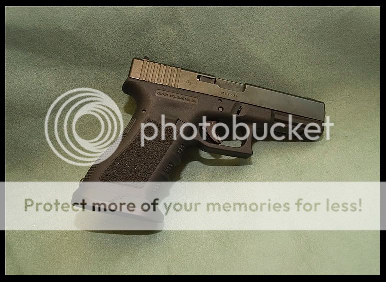

- Sevigny Competition Sights
- Extended mag release
- After market barrel (to practice with cheap cast bullets)
Glock 22C
Tru-Glo tritium/fiber optic sights
Recoil buffer
Tungsten guide rod
Titanium striker pin
Wolf striker spring
Titanium drop safety
Extended slide stop
Extended Mag release
Extended take down lever
Lightning strike aluminum trigger unit
3.5lb disconnect
Overtravel stop
Textured grip panels
Dawson Precision heavy mag well and slug plug
Tim
