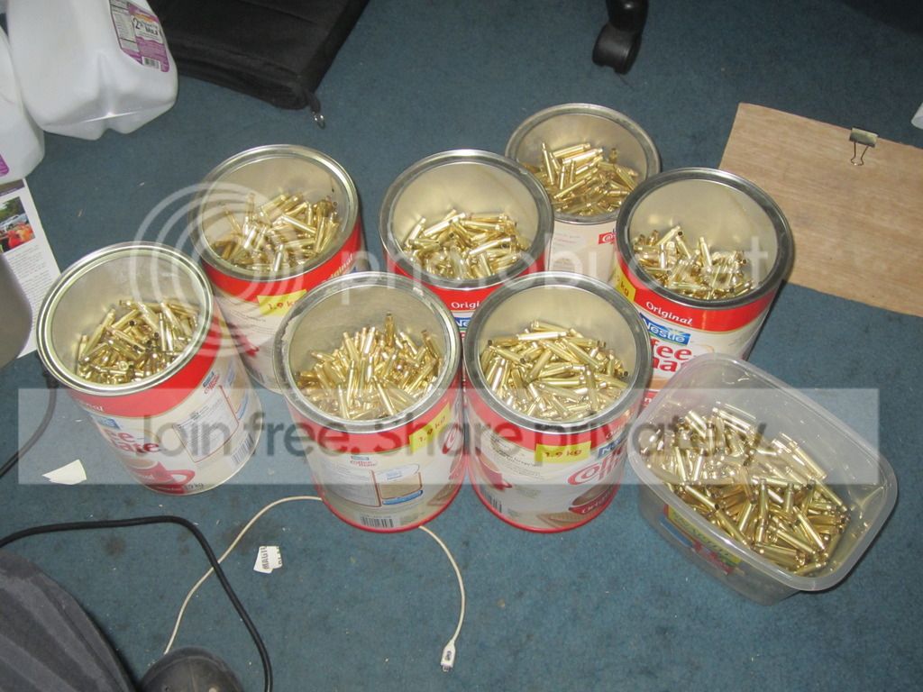

I load a lot of 5.56 Here are 5,000 primed cases, waiting for the Dillon.
