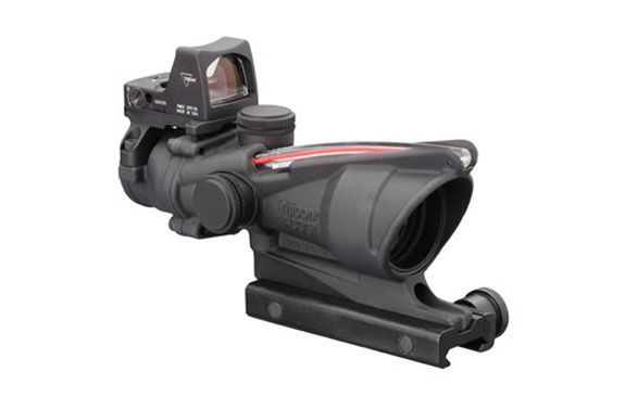

I assume MLP is talking about one of these setups.
On the topic of ACOGs, I've heard they use a 36m/300m zero. Can anyone explain how that works?
What you posted is a DUAL optic setup. The ACOG is the magnified optic and the RMR is piggybacked atop the ACOG. ACOG's are designed for a 100 metre/yard zero for most models.
The 36/300 yard zero is APPROXIMATE just like the 50/200 zero is APPROXIMATE.
