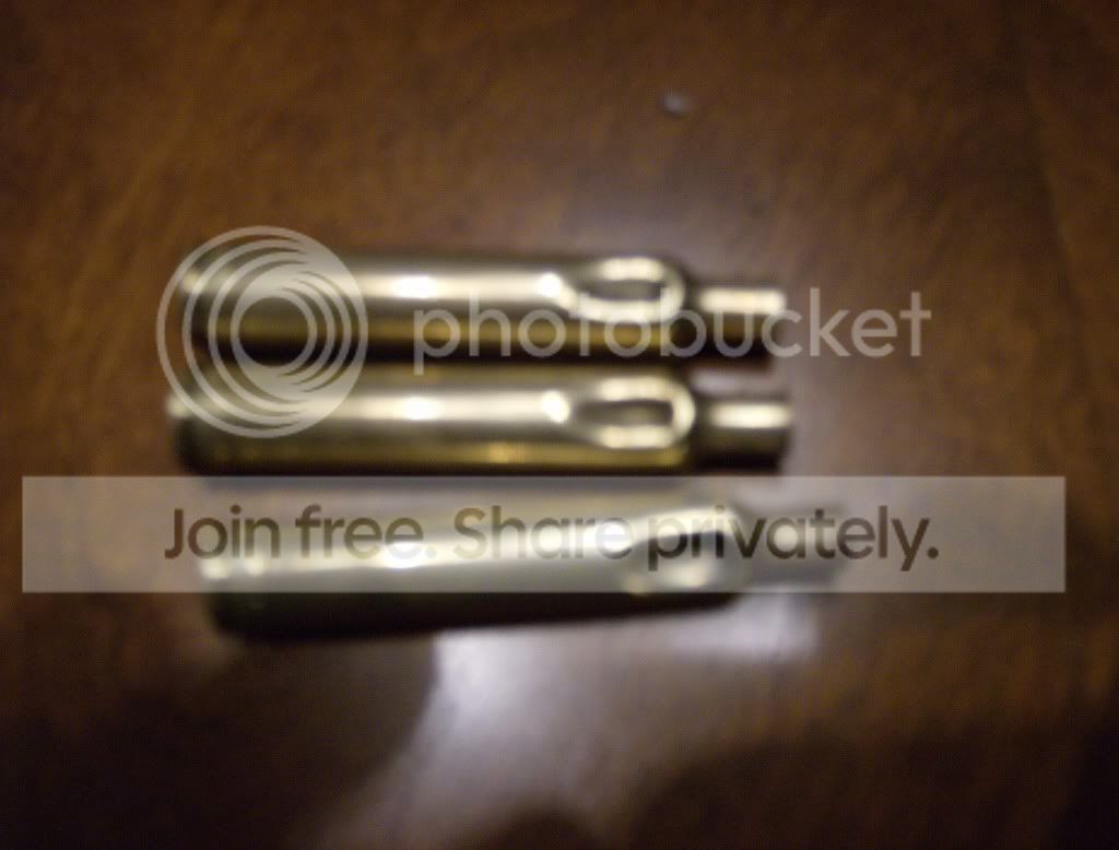

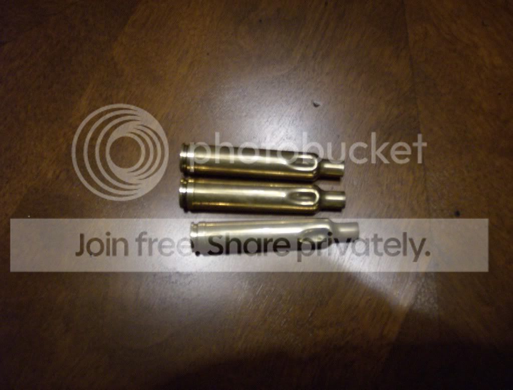

Went out to the range today (-25 celcius) To line up my .24 cal Coyote rifle aswell to try out some new loads...I had 24 rounds in total....8, Varget\8, IMR 4064\8 ,RL15......I first shot all the varget and IMR 4064 Loads with no problem,However on the 2nd,4th & 5th shot with the RL15 I got these massive crators near the shoulder of my brass.I decided Not to shoot the remaining 3 RL 15 rounds.
I know that thses RL15 rounds were not over loaded,however i'm not entirly sure what would have caused this to happen....? my only two guesses is that RL 15 is the hottest powder and load For a 55 Grain bullet out of a 240 wby and for some reason its to much pressure for my rifle, ....or It could be I was cleaning my rifle between the different powder loads and maybe I missed some solvent in the chamber and this caused a major pressure sign in my brass! aswell on a side note I noticed that the RL 15 primers did seem to be a little more flattened then the primers from the other loads.
Can anyone add to what happened here? ever see this before? Catnthehat?
Thanks,WJ

all 24 brass were the same length aswell all the fired brass is still pretty much within the same length.
