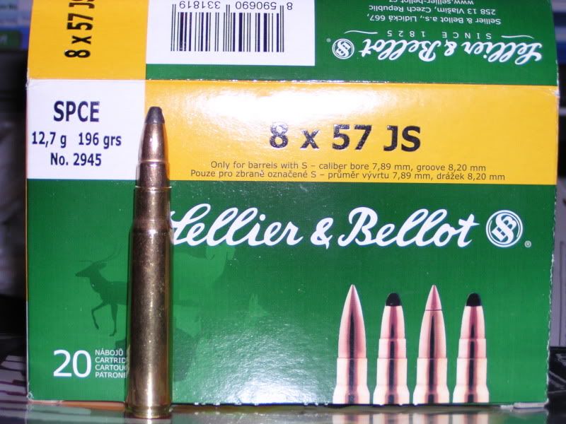

If you must have commercial ammo at a reasonable price, try S&B.
http://www.sellier-bellot.cz/rifle-ammunition-detail.php?ammunition=12&product=528
http://www.sellier-bellot.cz/rifle-ammunition-detail.php?ammunition=12&product=529
